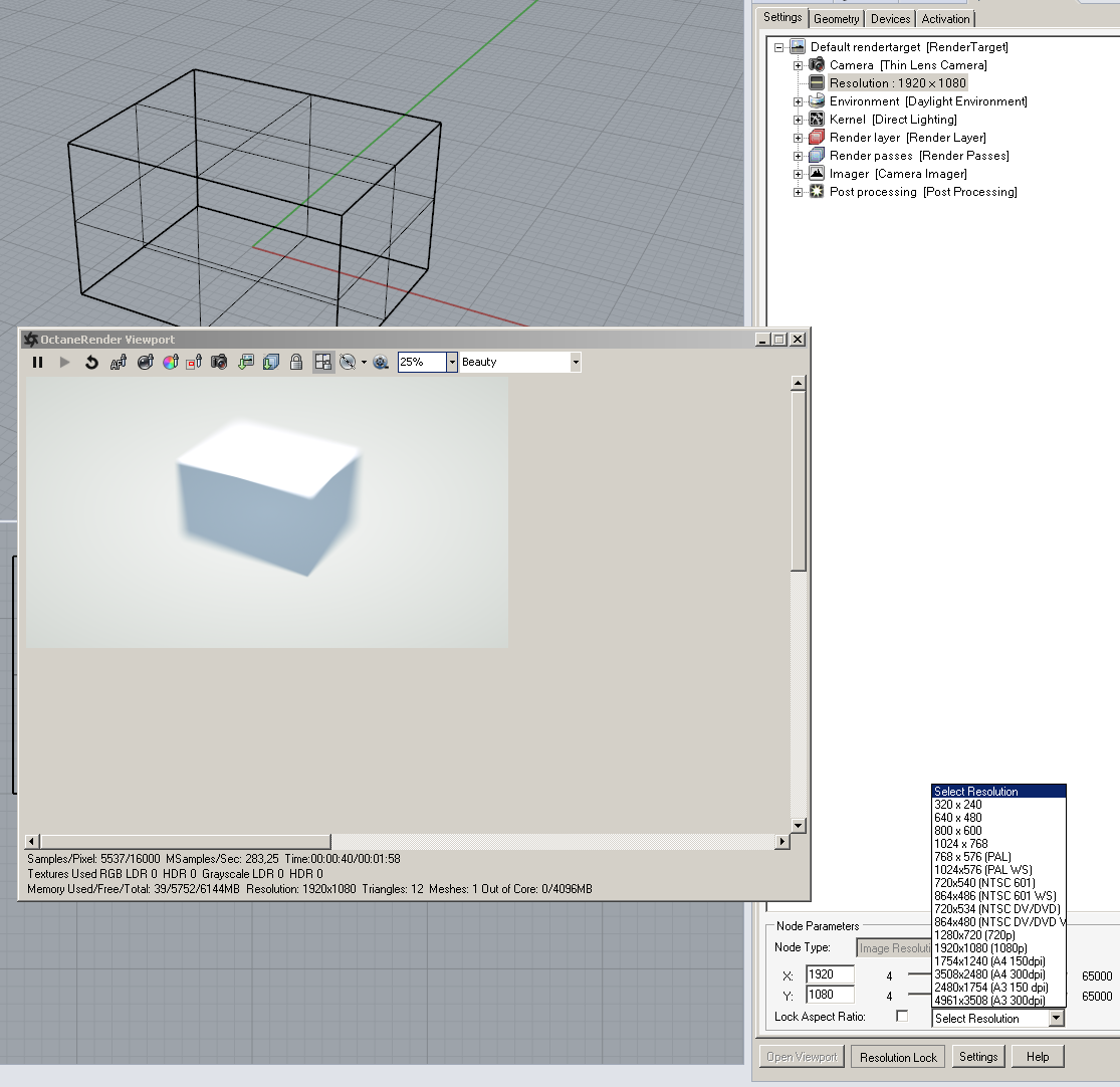

My request was to get an quick way that if the Octane viewport is set at 25/50/75/100% than the whole Octane viewport is scaled to match the rendering. For example if choose 50% than I try to see the whole rendering or I need more space at my screen. I need to manual scale the Octane viewport. example -> see screenshot
The option "Settings tree Resolution node Select Resolution->Rhino Viewport" isn't shown here - see screenshot.
When Resolution Lock is NOT enabled, the Octane resolution is sourced from the size of the Viewport window. So the plugin cannot then change the size of the Viewport, since this would then change the render resolution.
I suspect you may have tried an early demo version which did no include "Rhino Viewport" as an option, and the current installer does not overwrite that file. Can you pls unzip the attached file into your C:\Users\[username]\AppData\Local\OctaneRender for Rhinoceros folder, and the Rhino Viewport option should then be available.
resolutions.zip
(589 Bytes) Downloaded 390 times
I'm working on a FullHD animation and I looked for a way for a quick jump to half resolution without to change settings, only by scaling the Octane viewport.
Disable Resolution Lock, and you can set the resolution by resizing the Viewport.
