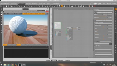

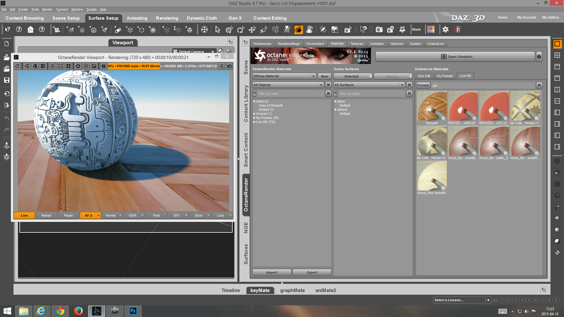

Nevertheless developer aoktar found a workaround that was shared a while ago by bepeg4d:
Displacement + bump trick
A material with a bump map is plugged into both slots of a mix material node.
Then the displacement node is plugged into the mix material node as well.
viewtopic.php?f=87&t=48024
