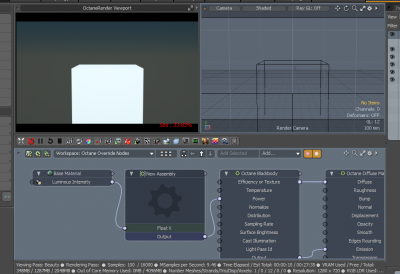

Yes, I have implemented a proof-of-concept method for doing this. The current release of the plugin allows a Modo RGB to be plugged into an Octane RGB. This needs to be done via an Assembly (pls see the attached file demonstrating this). I don't think this works for floats or ints yet (but I could be wrong on this...). The downside of this approach is that changing the Modo RGB does not automatically trigger a material refresh - you need to refresh the scene to do this. So I'm not sure if it is a workable solution for you. If it is, I could remove the need to go through an Assembly.

It is working yes, that's a work around for now, but reloading the scene each time can be a time killer on bigger scene :/

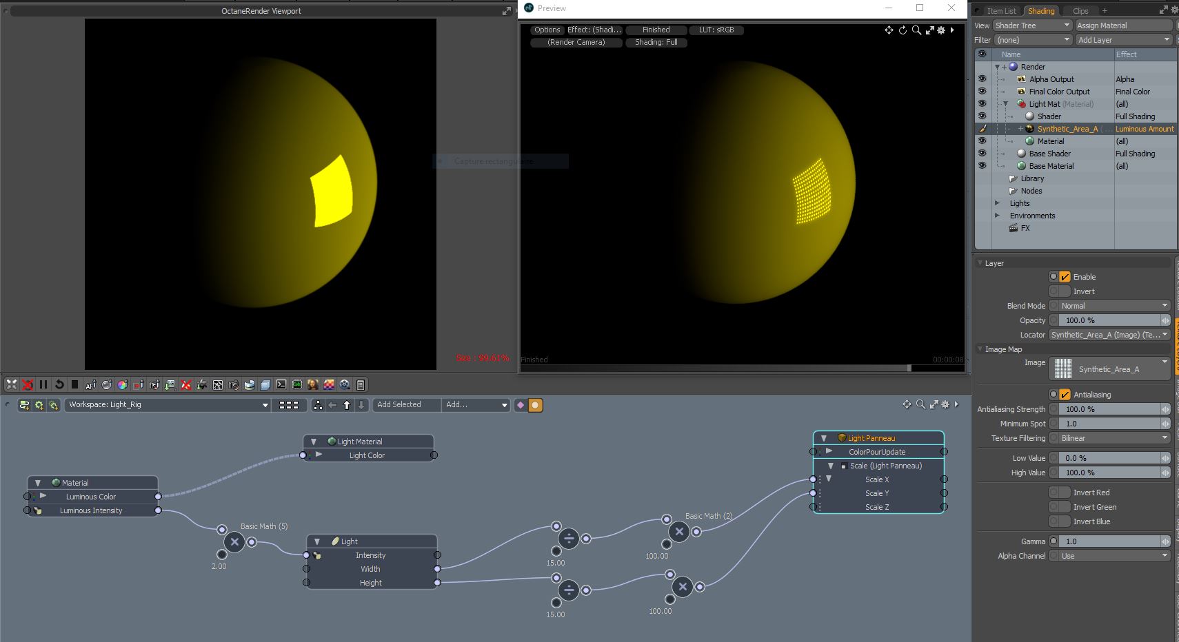

Maybe a explained badly what i wanted ^^ i would like to be able to put a map on a light, to see something in reflexion, and not just big square or circle, something like a gradient, or even an hdr taken from a real light to mimic more "realistic" reflexion. It's easy when you just need a luminous polygon for octane you can create something in an override easily, the hard part is that i would like to create a rig of light to control both a modo light and the octane one, were everything update themself on both light.face_off wrote:I had a look at this - and it doesn't really make sense from a workflow point of view. Luminous Intensity goes from 0 W/srm2 to 9999999 W/srm2, whereas an image map goes from 0-1. So they do not translate correctly. At the moment, the on-the-fly material conversion correctly convert Luminous Intensity to Octane Emitter Power. Can you not simply use that?I will add support for image maps assigned to an Effect of Luminous Amount in the next release.

I was thinking of using luminous amount because that way i can keep the color of the light, the map will just modulate the power (0 = no power, 1 = power in material intensity ), and add details to the reflexion or even lightning
Maybe it's impossible for now, maybe i'm not on the right way to do it, that's just something i wanted to do, or at least try to do ^^
As for the link between a material and a light it's simple, was just speaking about linking the light intensity and color to the material ones, and the width and height to the scale of the luminous polygon. This is easy, fast and gives a light that work both in modo and octane and react exaclty the same way. Problem is, i have no control over a possible map on the light, excepted if i work separatly on the light and in the octane override, but that's not the point here

Here is a really simple screen of what i would like, everything work, changing the material intensity and color update the area light, the only thing missing is octane who is not taking the luminous amount map

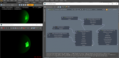

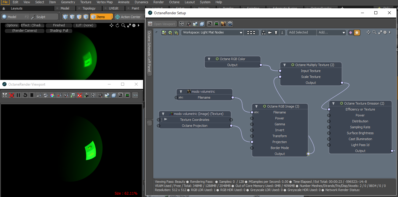

If the luminous Amount IMAGE is plugged straight into the Octane Emitter "Efficiency or Texture", then a) the Modo-Luminous-Intensity-to-Octane-Emitter-Power is incorrect, and b) the emitter texture is inverted, and c) the Modo Luminous Color gets ignored. To get around c) you need to adjust the Octane material to appear as per the attached image. So in summary, I don't believe that simply plugging the Luminous Amount Effect image into the Octane emitter power will solve your issue.

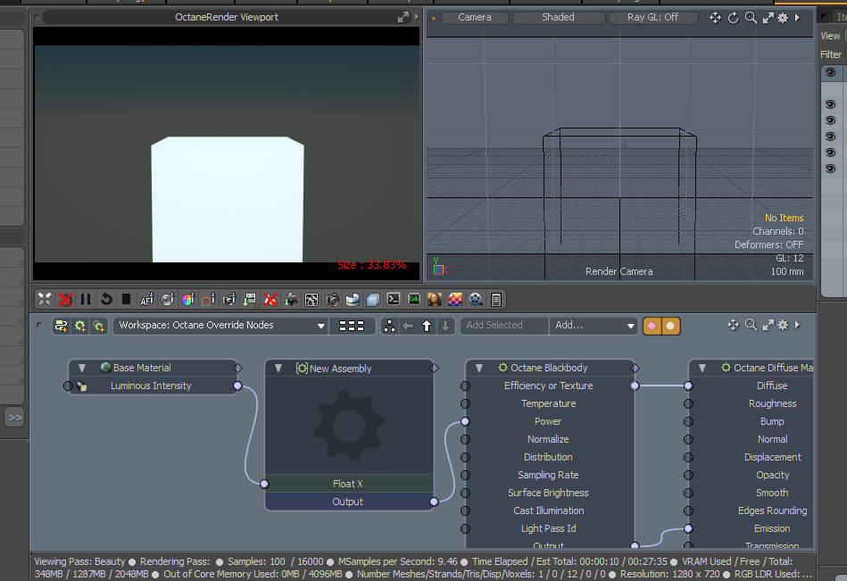

At the moment you can connect a Modo Color into an Octane RGB, but I would need to enhance the plugin to allow a Modo float (such as Luminous Intensity) to be plugged into an Octane Float. Whilst this is relatively easy (and is in the next release), it will only auto-update if the source channel belows to a Modo Material (since changing a Modo Material property/channel triggers a full material reload). I simple test shows that the Luminous Intensity property can be attached to the Emitter Power using this approach, and it updates when changed. You need to pass the "Luminous Intensity" through a sub-assembly to get around the plugin detected a mis-matched node connection.
Hope this helps. Next release should be out in the next day or two. Apologies for the "hacky" nature of the solution.
