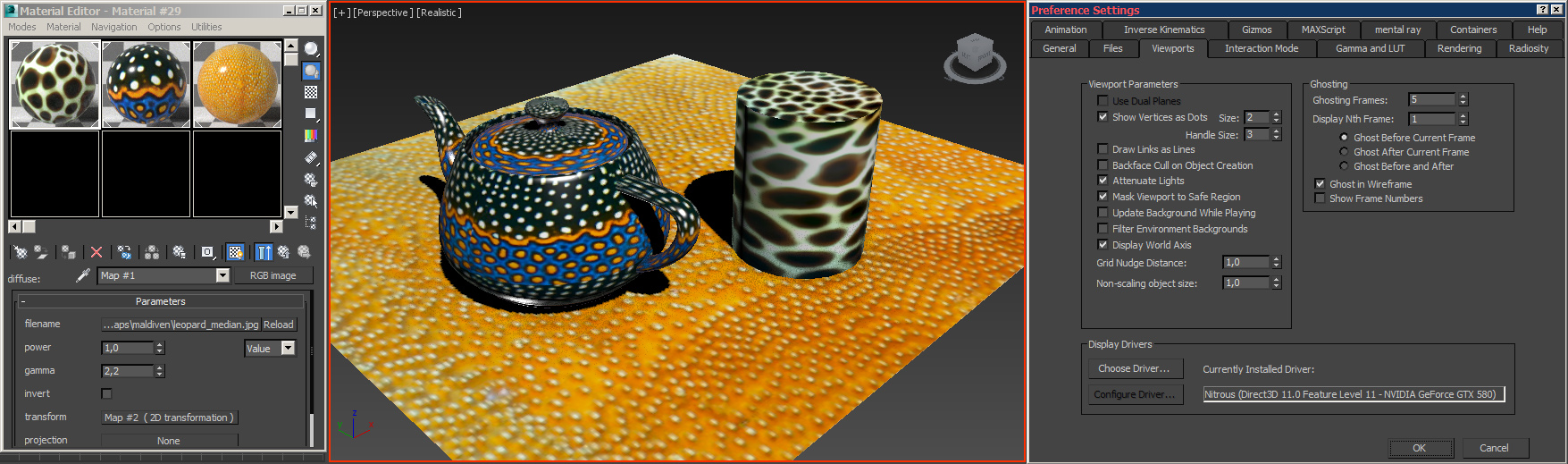

Hey All,
is it possible to view the textures of octane shaders in the viewport?
It's quite frustrating to work "blind" when aligning uvs / cut through reference planes etc.
And using the old standard-materials for previewing and then switching / converting to octane materials also is quite a hassle.
So is it possible to enable this?
thanks for your help.

should have written that I am using 3dsmax 2011 which doesn't have nitrous.
And neither opengl nor dx 9 / 10 show textures in the viewport. :/

alright I found the solution. :D
If I right click the diffuse / specular material the "show standard map in viewport" option is greyed out.
But if I right click the "rgb image" node the option is available. And turning it on makes the image visible in the viewport. :oops:
Currently using directX 10 in 3dsmax 2011.
Thank you guys for your help. :)
