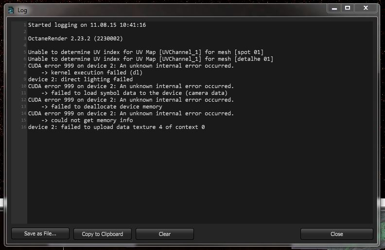

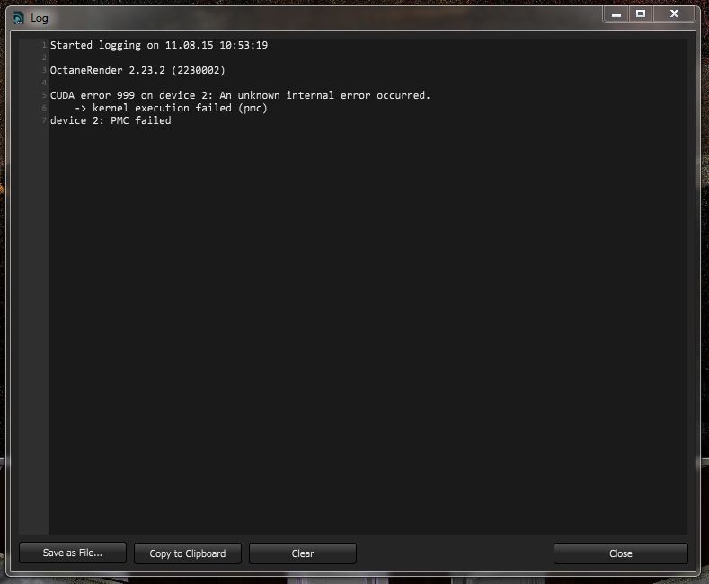

Mate i'm bumping into this error all the time now and can't get it to work anyhow.
Error 999:
After 999 happens, i need to reboot my machine otherwise my titans won't load anything again.
It starts rendering then screen flashes and NVIDIA message pops saying that the driver crashed and recovered. 3D applications don't crash due to this error. However octane stops rendering.
It seems to stick to the scene, after the error happens it will remain with the scene, somehow.
Can't track what is going on, first i had UV errors, thought they could be trigering it, but not really, i deleated the UVs from the meshes and errros still happens.

Hi Raf - I'll download and try your scene. However, in the vast majority of cases error 999 is a hardware problem. Try underclocking your card(s), or just rendering to a single card to determine which one is at fault.

I and Rafael Vallaperde worked at the same company and I was also participating in this work,we try to decoupage the problem and in our tests whats caused the problem was the material called "cortina atras" "cortina azul" "cortina amarela", when we exchange these materials all went well

999 doesn't seem to be hardware related here, as Coppola said i investigated a lot and found out that materials were creating the error. First a though a .tif texture was causing the issue, erased the material and it started to work.
Another point that makes me believe that it isn't related is that the error happens in 3 different machines. the same way.
Later on, i noticed that that problem wasn't related to the .tif, it was related to leaving unplugged nodes in the sschematic(many).
Sometimes in my workflow if i want to tchange the material i'll simply unplug the nodes that create one material and create another branch. This seems to be causing the error.
