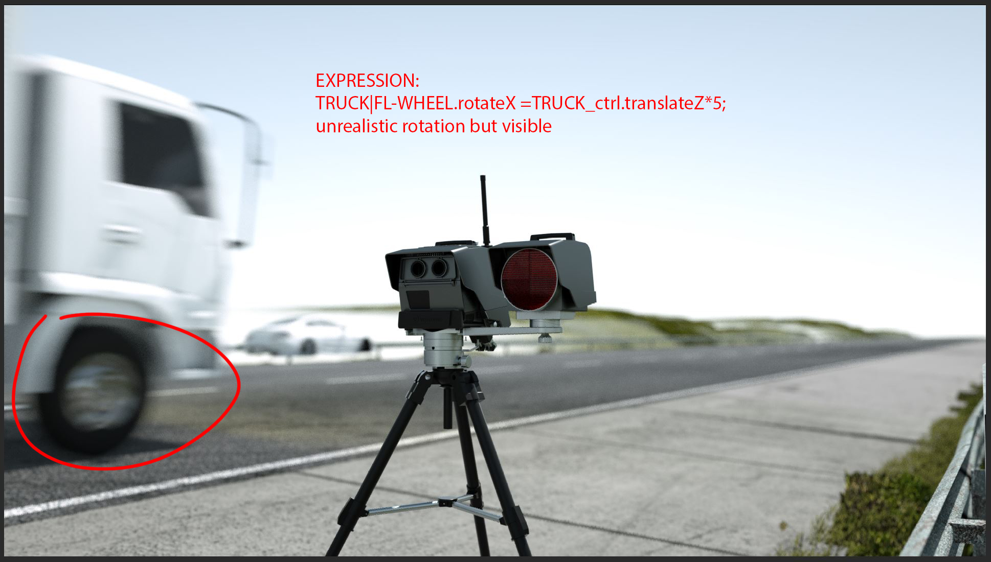

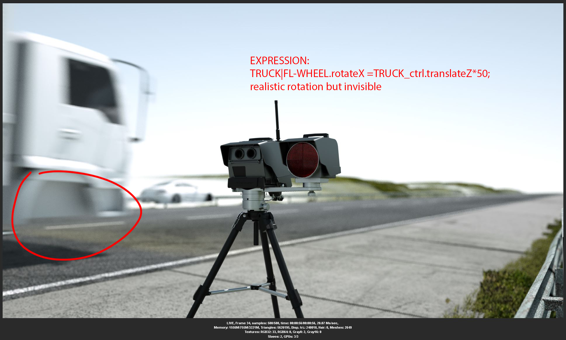

My problem is the internal motion blur feature in octane for maya (2.23.2)
It looks perfect to me and the render time is just a-a-awesome,
but it seems there is a problem with the expression I wrote to animate the wheels by moving the truck's Z axis
( "TRUCK|FL-WHEEL.rotateX =TRUCK_ctrl.translateZ*50; ) The Settings of the Motionblur are:
Motion blur type: Internal
Cam shutter (seconds) 0.0100
MB direction: After
As you can see in the screenshot, the motionblur just works fine for all moving objects except the wheels. They almost disappear.
When I edit the expression to "just 5 times rotation instead of 50 times" the wheel is back but the rotation looks unrealistic.
And i need it as realistic as possible because of some super slowmo's
