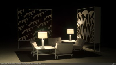

Sorry hadn't returned to the forums for a couple of days...been knocking something out. Here is a pic of something similar. http://office-turn.com/wp-content/uploa ... Kenroy.jpg

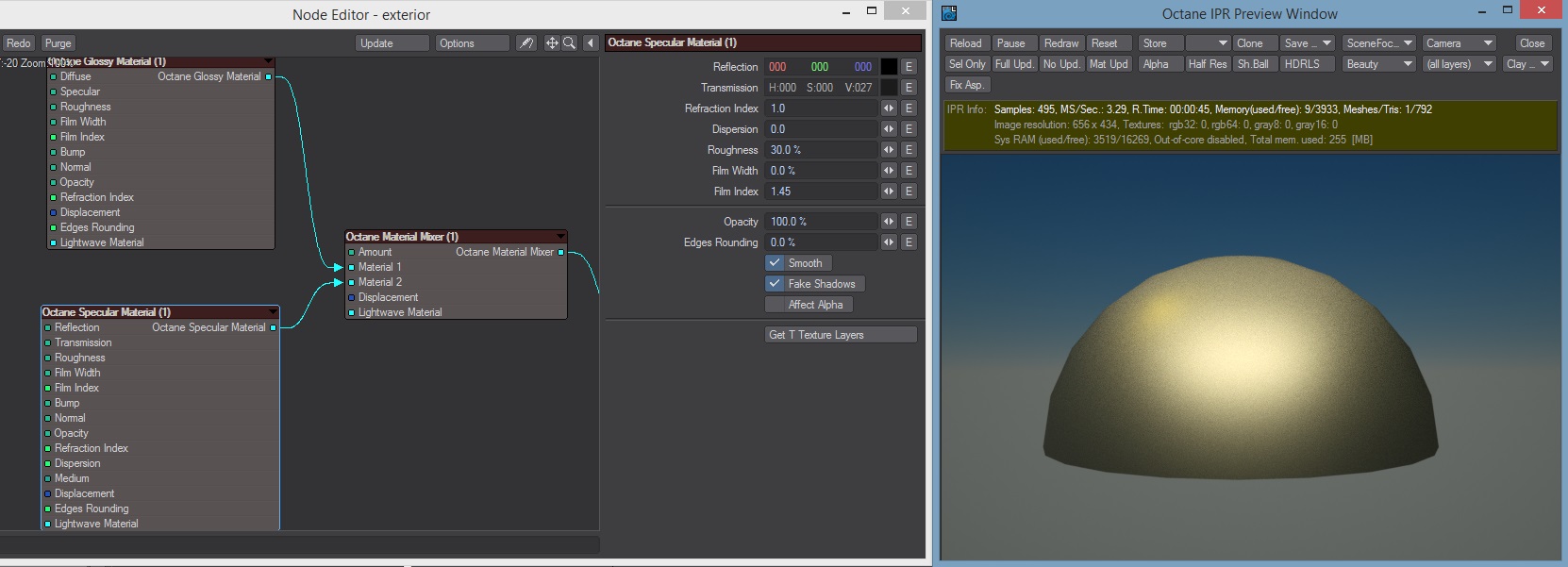

I think that you could use a mix of two materials, one glossy and one specular. The specular roughness feature can simulate the light dispersion in translucent lamp. Attached you have the scene.

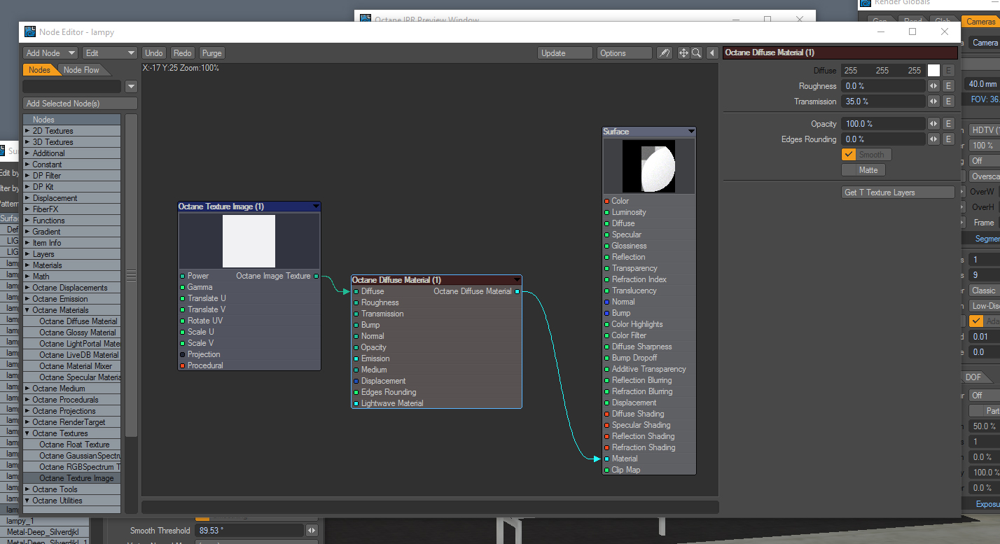

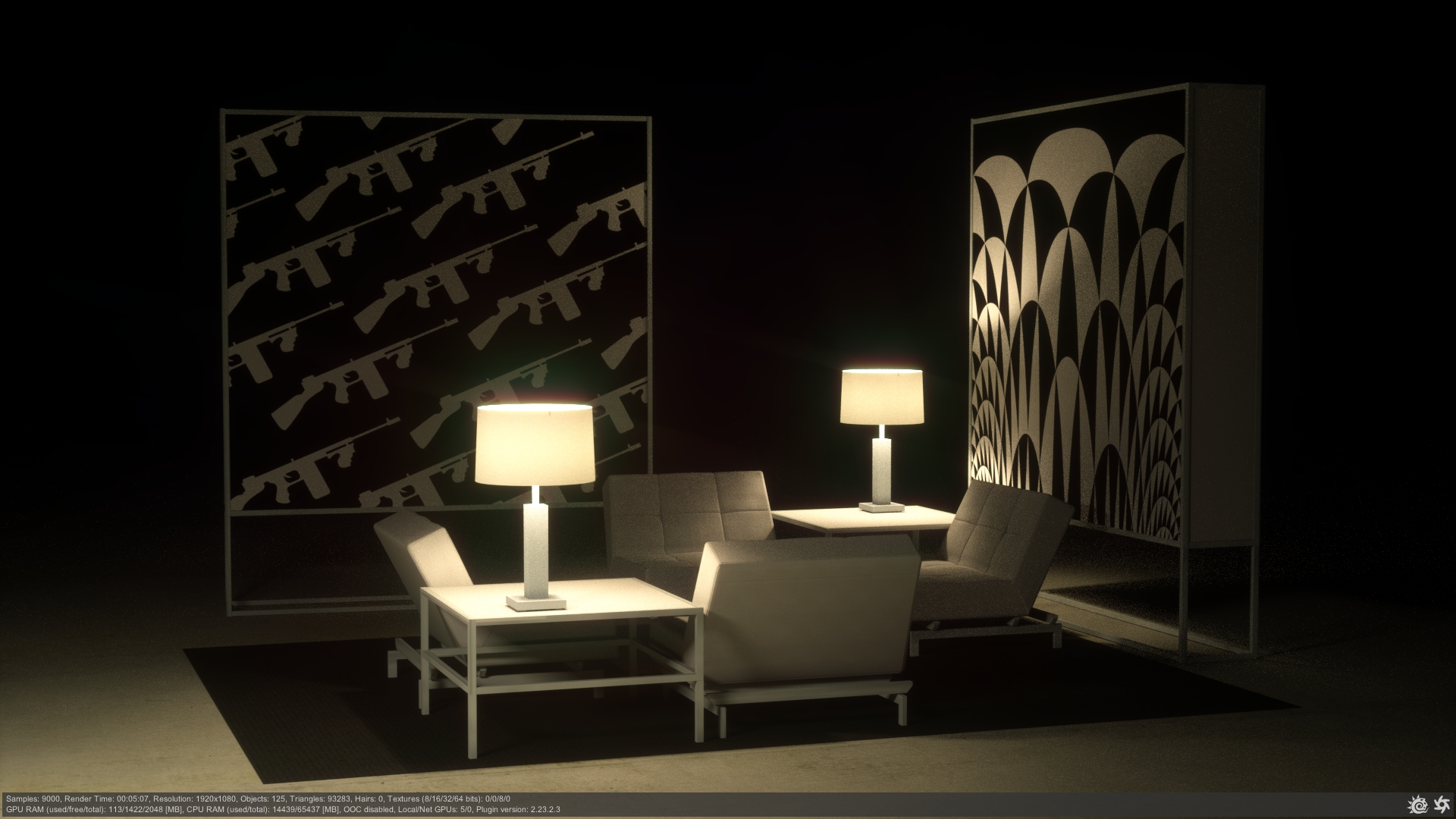

To create lampshades transmission I gave the lamp's light bulb a Texture Emission with a power of 5.0, then I gave the lampshade surface a transmission setting of 35%. I rendered with the Direct Lighting Kernel set to Diffuse with a Diffuse Depth of 2. Hope that helps.

I'm using a Diffuse Material with a white *jpg in it's Diffuse channel, seems to help with the transmission. It's a simple setup, you should be able to mix Specular or Gloss in if that fits the look you need.
