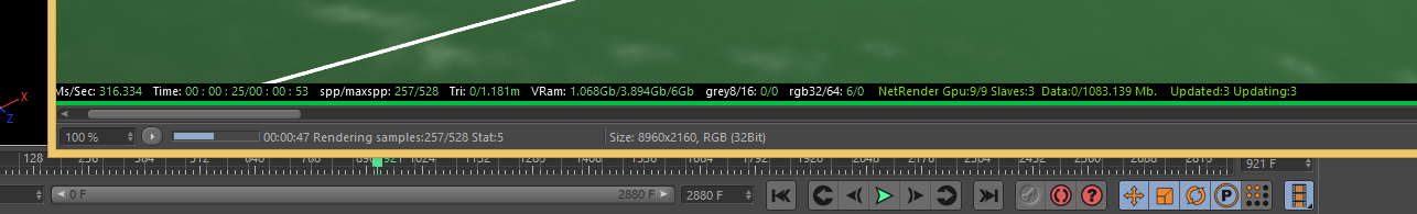

I've attached an image to show the stats at the bottom of the picture viewer. I am not using render passes anymore because of the extra time added per frame and it seemed to eat up a lot of resources. I haven't let this go an extended period of time on one machine, just because the extra boost is nice :D but I agree that this should be tested on one machine to see how it performs.

Scene seems that spends low resources. It's ok. I think there should be another problem on clients. Have you tried to use this farm setup for some different scenes? Can you confirm your setup's stability?

I noticed from your screenshot that you are losing some VRam in the master.
Are you using one GPU for both monitor and Octane without the priority option?
Have you disabled the "multi GPU" option in the nvidia control panel?
Are the slaves setting up in the same way?
ciao beppe

Yes I feel like VRam could be the culprit here. Sometimes it will render for 100 frames and then render for like 10 frames and freeze. :(
On the master I am using all three GPU's for rendering. (All 3 980 TI's) The priority is not set, meaning I am using everything the master can give.
I haven't checked out the NVIDIA control panel for the multi GPU setting. I do have SLI disabled for all machines involved.
The slaves have identical hardware. Each same motherboard, RAM, GPU's, CPU, etc.
Thank you!!
