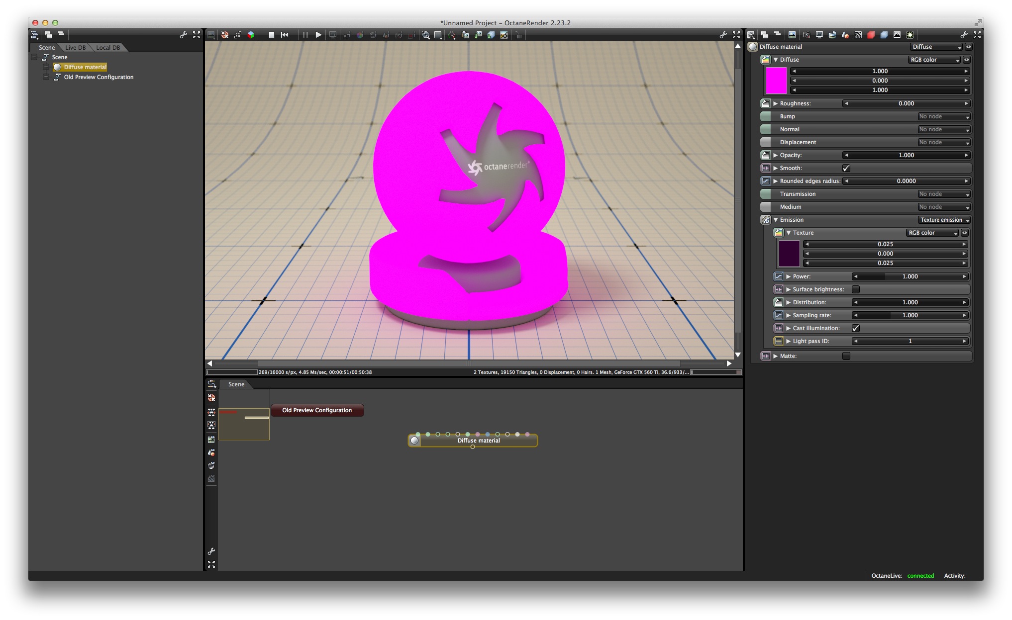

about the "low power texture emission node", sorry, I had to say "low power efficiency texture emission node". Here is a screenshot of what I mean, basically you have to lower the Value in HSV color space to correctly see the color:

Hi, you can use a color correction node to lower the brightness and I forgot to mention that you need to uncheck the "Cast illumination" option. In this way the emission affects only the material itself but does not emit light all around:

Thanks again, but I am still getting slightly darker values than they are in input .tga texture files . (no vignetting) Tried it with your file too. Wonder if that 0,025 brightness value has some math origin or should I play with it on my own?
Q6600, 5GB ram, GF9800gt-1gb, 3dsMax 2008 , Blender , Zbrush, Messiah 3d v5, Terragen 2, Vue 6 Infinity
Posts: 10467
yes of course, you can play with the value to find out what is better for your needs.
Another option you can use is to activate the "surface brightness", in this way the illumination is no more related with the emitter dimensions. You can play with both the Power and Texture Brightness for fine tuning the effect ;)
