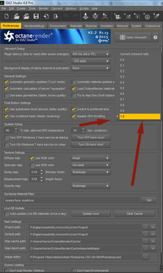

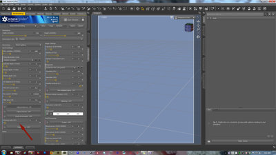

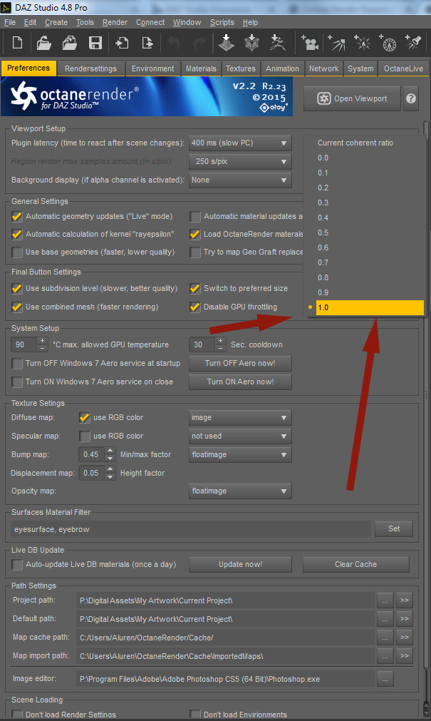

I think by default it is off, so may not be your issue. Unless you use final render mode. Also it is not available for PMC mode but not sure you mentioned that or not.Spectralis wrote:Where can I find coherent ratio and how do I switch it off?larsmidnatt wrote:are you rendering with coherent ratio on by any chance?
Kinda sorta, but not exactly reminds me of what I saw when i rendered a turntable animation with coherent ratio on.
This setting can greatly speed up renders, but works best for stills or low speed, well lit animations. It may not be at all the case for you. but may be useful one day. The issues you are seeing are not exactly what I saw when I used this setting anyway, but was worth a shot.
I attached where the setting is for the final render menu and rendering settings just in case.
0 is off. 1 is full blast. Terrible to use during previews! Not a bad option for final renders(great speed increase, but has quirks and strange artifacts for animations at times).
