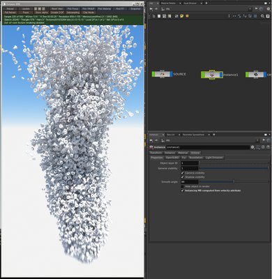

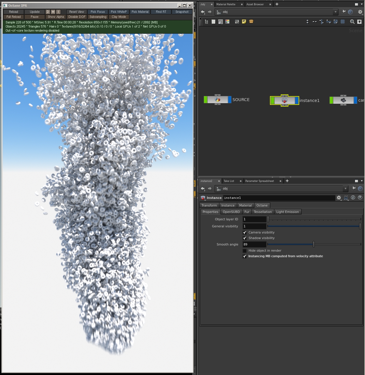

Done, available in the next build
New parameter "Instancing MB computed from velocity attribute" in the Octane OBJ custom spare parameters. Can be enabled in the OBJ instance nodes to compute the instances motion blur using the "v" velocity attribute. Useful when instancing over particle system or other OBJ nodes with variable ptnum IDs, or when only the instances translation motion blur is useful in the scene.
