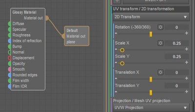

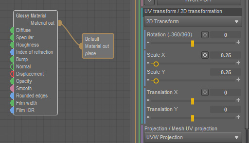

In case you don't want to physically resize the texture itself, but you just want to make it 'smaller' for tiling (seamless textures) then you need to use the UV Transform pin in the NGE:
And then decrease the following values:
Hope it helps. ;)

In the octane render tab for each texture there is a dark grey area "UV transform/2D Transformation"
Click that. Then it will expand and show you rotation, scale x,y, translation x y
In my case I don't typically have a 2D transform pin and it's all collapsed inside a simple material. So I find the UV transform on the tab on the right. Point is you can get to this in the NGE or with the regular Octane render materials tab.
There are a few more parameters exposed if you go into the NGE which is pretty common. So they look slightly different.
