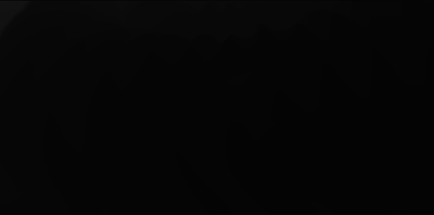

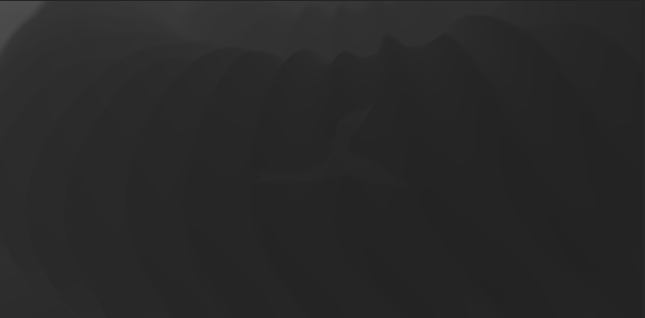

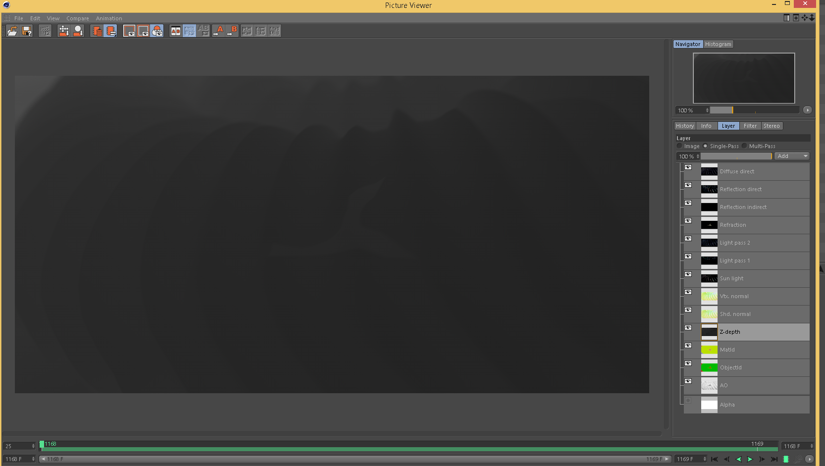

I have said already that I have my settings all at 32 bit and my file is tiff. I would appreciate some guidance as to what else I am meant to do. I am seeing the correct result in the picture viewer but I am getting banding in the tiff file as shown below.
Software: Cinema 4D r16, Octane v2.24.2 R1
Hardware: Intel Core i7-5930K CPU 3.50GHz, RAM 32 GB, 3x GeForce GTX 980
Posts: 16068
Location: Türkiye
Render buffer: Float or Float(tonemapped) and saving as 32 or 16 bit.
Nothing else required as i remember correctly. Also you see correct results in Picture Viewer. I don't know which software are you using to check but PS or AE can't display well 32bit images. Make a search in forum for banding, there was some discussion and see conclusion.

I will have a look at the settings more then... but it seems it may be After Effects and Adobe in general that is at fault... which is pretty damning considering how important they are as post production tools. Why are they bad at reading 32 bit files.... find it odd no one has said this to me before.
brasco
Posts: 198
Joined: Wed Apr 13, 2011 2:56 pm
It's not that they can't handle 32bit , it's that they need to be configured correctly, can you save out a test file and we can maybe help find the issue. It's usually adding in a color profile that causes problems.
