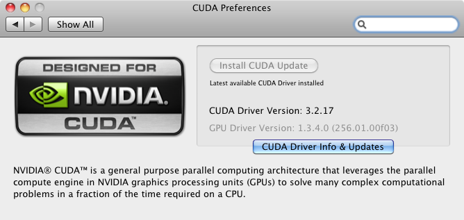

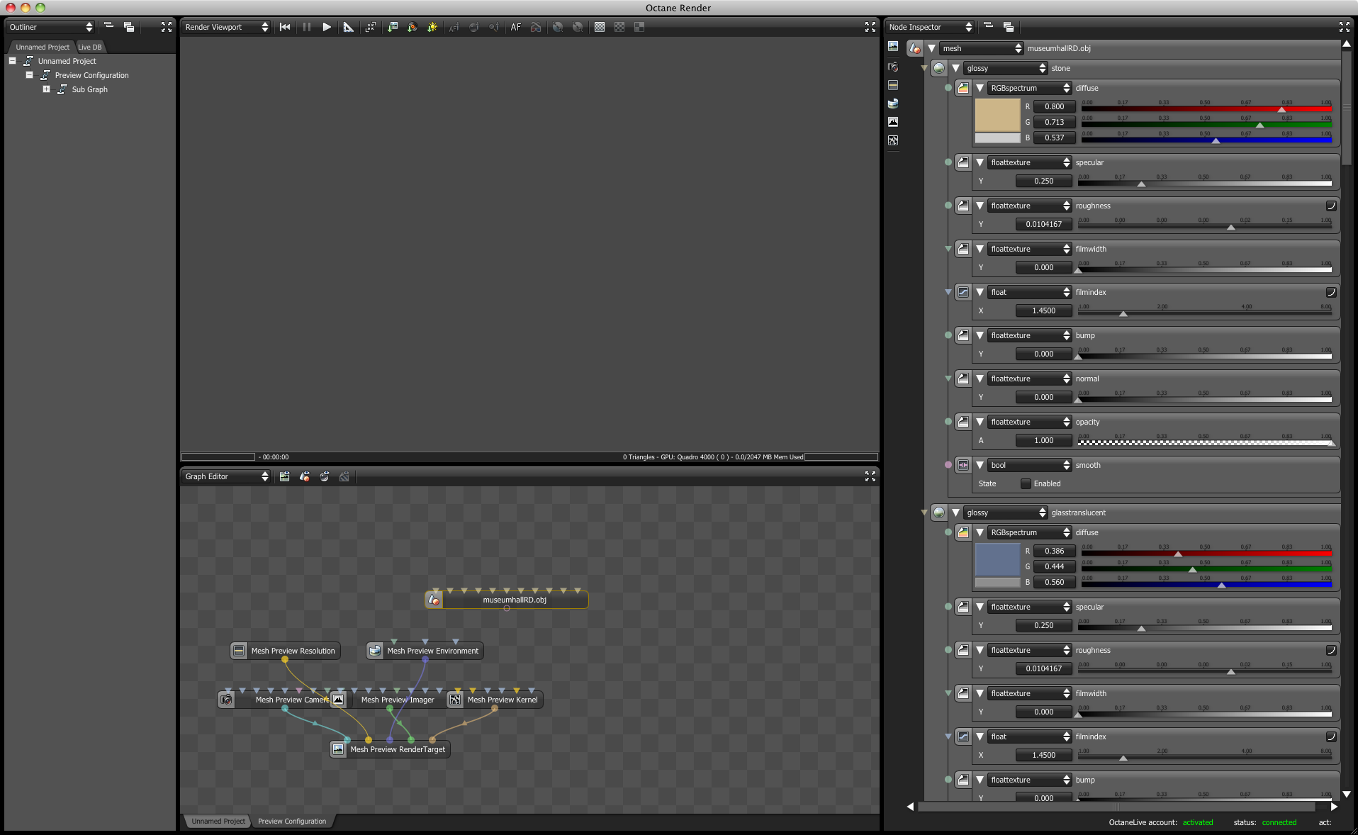

I just got the Quadro 4000 Mac edition to review and wanted to use Octane as a benchmark but Octane doesn't work with this card, it seems. I have CUDA installed and it worked before with the GTX 285, the card shows up in the preferences but when I click an imported mesh, nothing happens and it shows 0 triangles. See attached pics. I also get a crash on exit. Log attached.

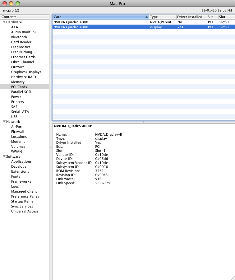

do you think this could have something to do with the problem. There are two displays showing up in the system settings, which is weird.
