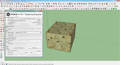

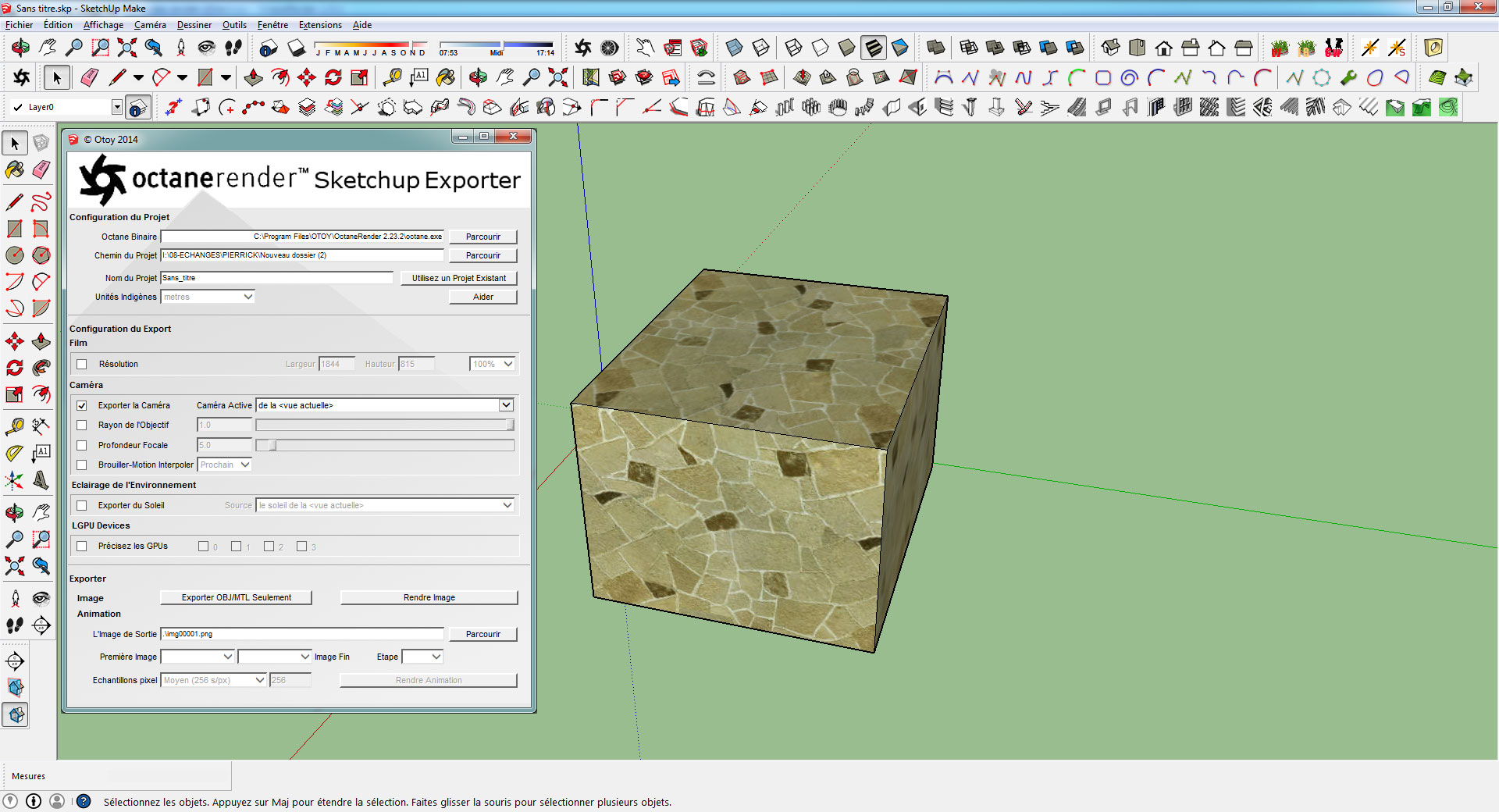

Hi ALL
I use to export your version 1_00-05 v 2014.
but recently I install the 2015 version, the texture file is empty for each export. can help me?
I do not use the plug-in Sketchup it is not compatible to my needs, the standalone version is better.

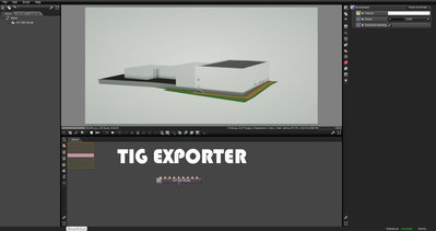

thank you for your help, but I personally only use the export TIG, I have re-installed, it works again. but as soon as I use plugin octane, export TIG no longer works.

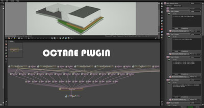

The exporter.ocs the plug in create many Obj file (groups + components) it's useless.
One .obj is enough, and color is equal to a material here is an example with the plugin and export TIG. (We should add the views and materials or leave the choice to the user in the pre-recorded preferences)
We must minimize the Graph Editor at export level .ocs
But the plug-in is very well SKETCHUP for Proxies.
THANKS.

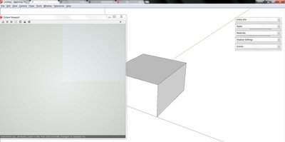

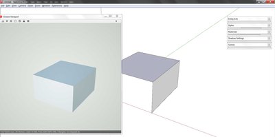

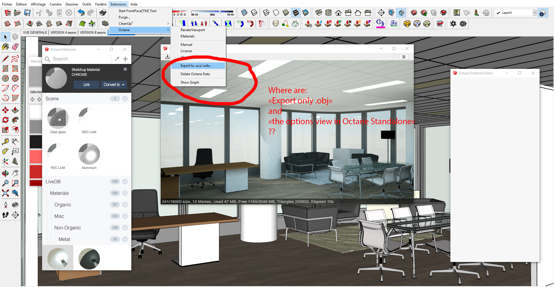

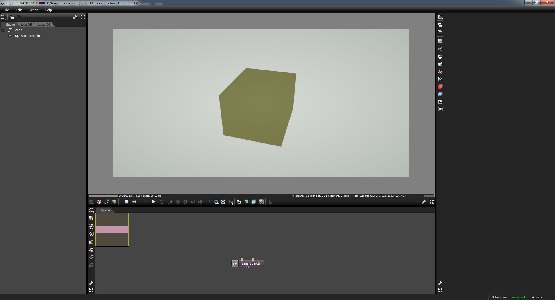

Yes, I can render out the scene that way. Recent updates have bungled the OCS/ORBX export. -see attached.smicha wrote:render your scene, hit pause, go to plugins -> octane and export as ocs.fivebythree wrote:I don't have that export window in my SketchUp Plugin.
Is it available somewhere?
Everything is fine...
Where's the geometry?

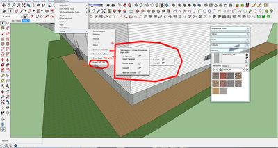

When I do this with more complex meshes, the result is nothing. Place the proxy, and nothing appears. This needs to be fixed. This is the only reason I've been using SU2014 / octane v.013 to create proxy geometry. I'm a daily user, having to work around these issues affects business.
**In the post above it appears that there's a dialogue box for octane options. These are simply not available in v0.15**
