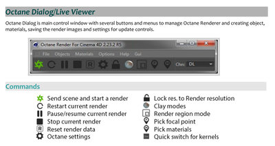

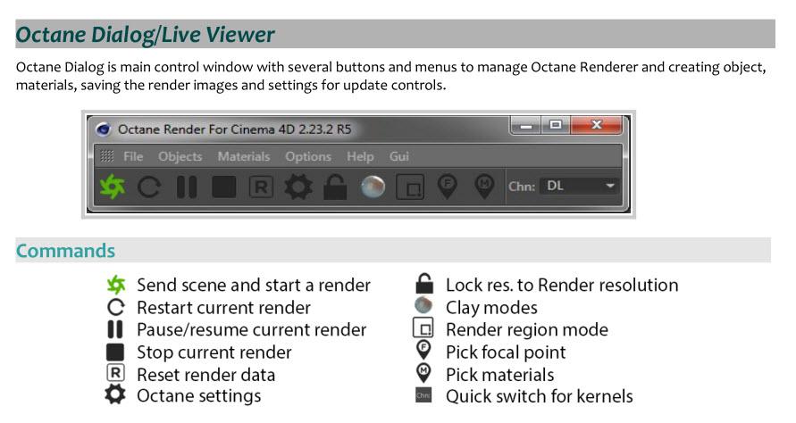

Ok i'm going to add more info for buttons. But i don't think that's so complex to solve. Btw, if you watch our tutorials you will not have so much confusions about buttons or LV.
When i look to buttons, three of them are important.
Start button: Rest all gpu data and resend your scene. All buttons are inactive(include Start button-grayed) until new render sessions start. So that's not a toggle button.
Restart button: It just restart render from maxsamples=0. As it does that when you change somethings.
Pause/resume button: I suppose that's most clearly named buttons. Pause or resume current render without delete any gpu data.
Stop button: It simply stops current render. You can't resume that you should restart with "Restart Button". It doesn't reset any data.
Reset Button: It stops and clear all gpu data. This is fine for freeing the gpu memory without closing LV. At this perspective, "Stop" button can be seen as unnecessary.
