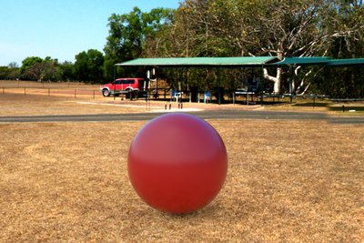

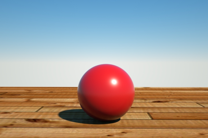

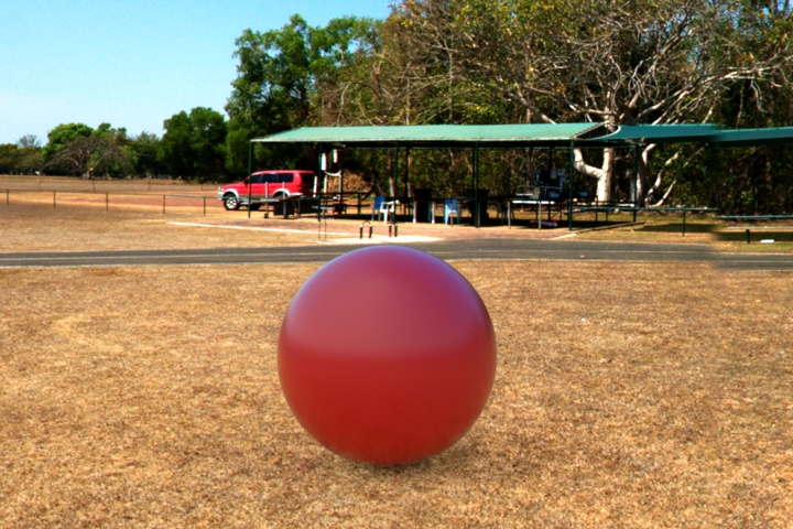

Would like to see if anyone has tips on how to increase the strength of a shadow by an object (ie a sphere) against a ground plane when using a HDR as Background Environment.
I am getting really weak HDR shadows.
I know how to select the ground plane material, set it as diffuse, and then set Matte to 'On' in order to have the plane not show up in the rendered scene while preserving the shadow.
And I understand the HDR lighting determines the initial shadow strength.
However, I am interested if there was an artificial/simulated way to somehow combine the shadow making power of the daylight background environment with that of an HDR background environment, in standalone app.
Daylight Background Environment -  Hey, Nice Shadow!
HDR Background Environment -  Shadow?...Ummm...check the lost and found
Also, I think I saw that sphere outside of a Target Store, and I think it had a shadow, but I'm not sure...
Anyway, Thanks and Regards!
