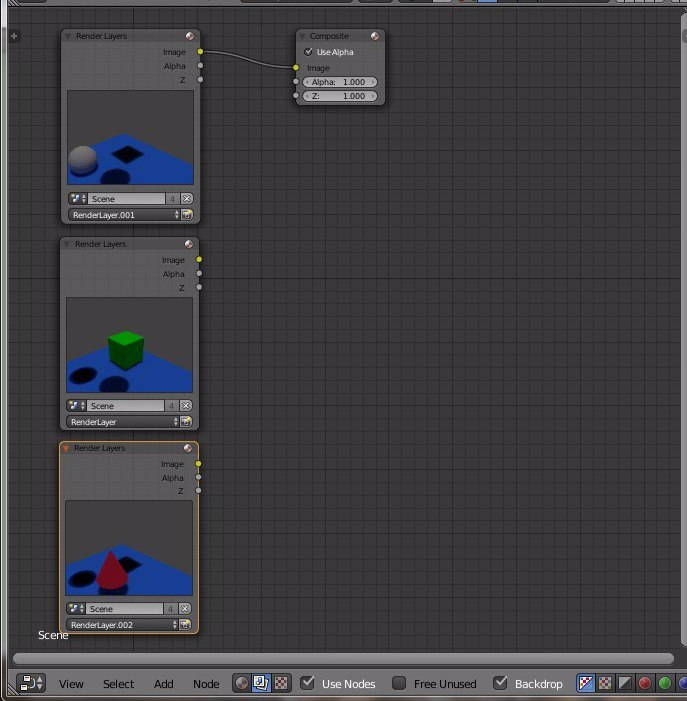

i've tested. guys! Its working, but there is one specialty.. Sun and global lighting is on the layer 1. I can understand. But if i contain for example a object on layers 2, 3 without meshlights sun does not illuminates him. If i create a meshlight on this layer i can see that sun illuminates the surface.
U can see in example file "example layers with meshlights" sun illuminate all layers, in file "example layers without meshlights" i delete all meshlights, so sun illuminate only 1st layer objects

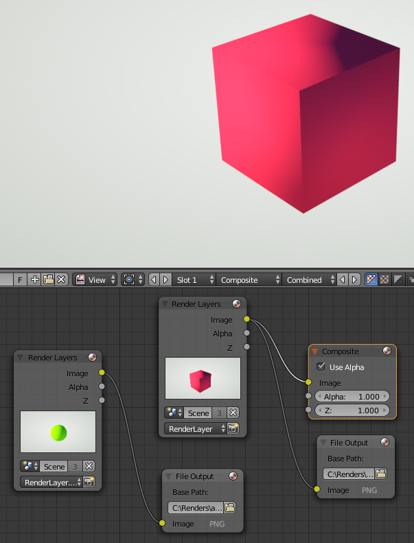

Here is an example of cycles render layers.
As you can see - Light affects on all layers. Normally, it must be so, for example if I want to render the fog with the shadows from objects away from the objects.

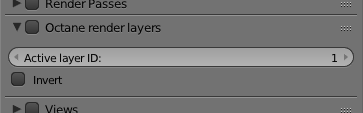

If you need the native Octane engine layers - there always was the different rollout for this: "Octane render layers" plus the layer number that can be set to the mesh object.
Screen Shot 2015-07-17 at 20.54.07.png (8.7 KiB) Viewed 6453 times
Screen Shot 2015-07-17 at 20.54.38.png (5.52 KiB) Viewed 6453 times
The difference of native OctaneRender layers - you can't select more than one layer rendered at one time.

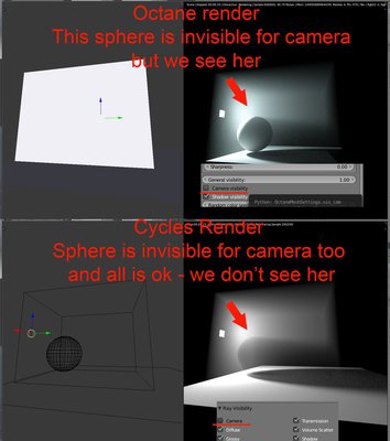

JimStarm, Thank you for all explanations, but problem not in it, let me explain in example:
If a standalone version work similar i can copy my question in general discussion.

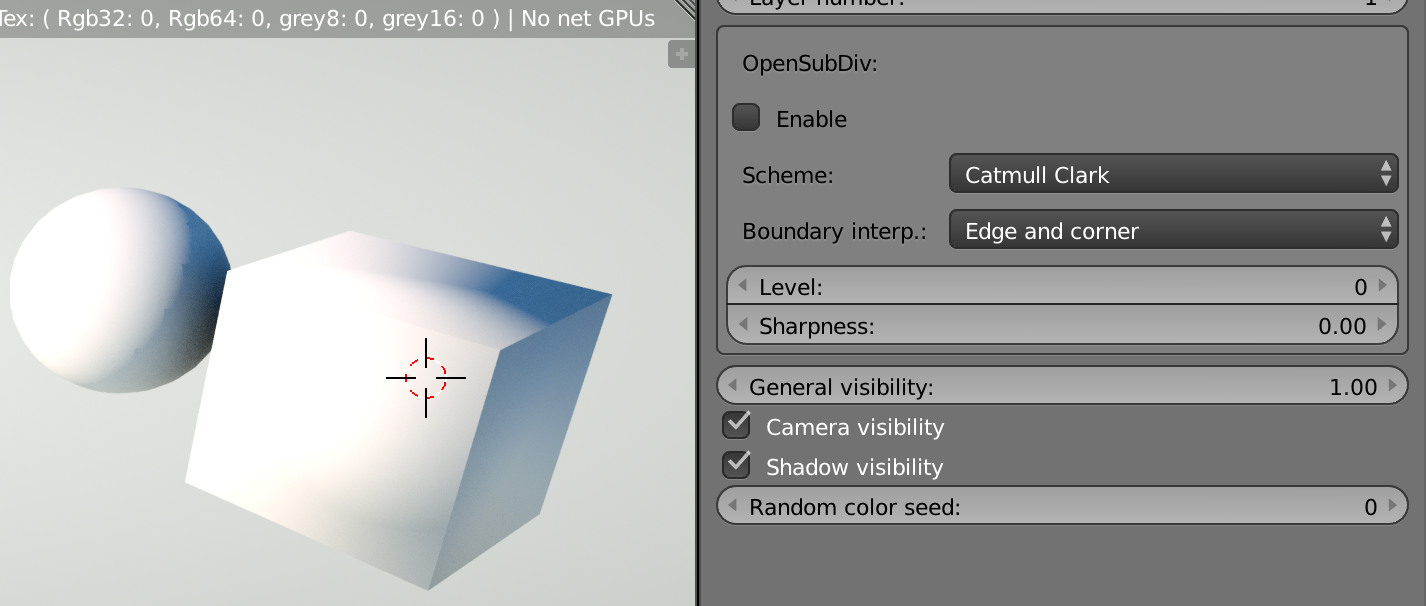

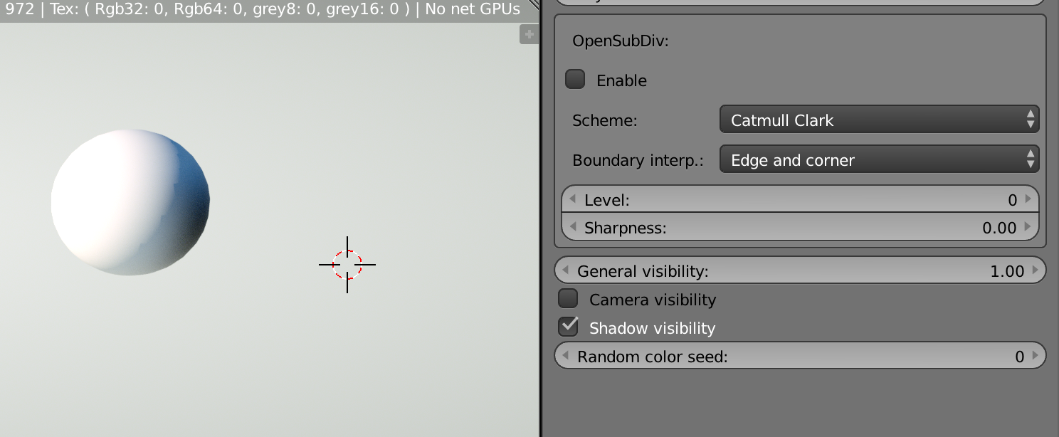

1. This question is nothing to do with Blender render layers. I hardly can understand you when you are jumping between unrelated things...
2. The camera visibility works OK both in standalone and in Blender plugin. So, search the problem in your scene.
About your scene with Blender layers. Please don't forget what I've said you about the camera. The scene you shared here has the camera focusing set incorrectly, this is why it renders wrong in some layers.
