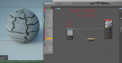

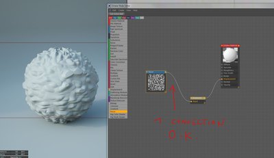

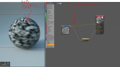

But what I encountered is, that when I make a second connection from a C4D-Noise-Node,
the effect from the 1. connection gets lost.
I think, duplicating the Noise-Node and making 2 individual connections (which works)
is not the purpose of a Node-System, because I only want the make changes to "one"
Noise-Node.
Is this a limitaion for displacement or C4D-noise-node?

it's clear that there is a problem with same shared connection on displacement node. But i don't know what causes. I'll investigate and try to fix. Otherwise i'll leave it as it be until find a fix.
Disable/enable functionality is on my todo list. I'll try to implement it soon. Thanks for report.
