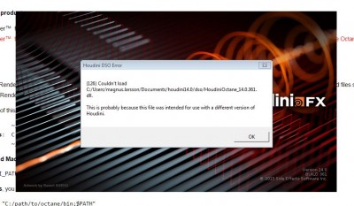

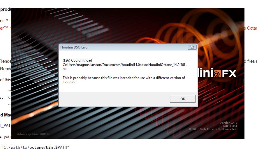

Getting this ?
juanjgon
Posts: 8867
Location: Spain
MagnusL3D wrote:Getting this ?
This seems a problem loading the the plugin .dll, usually due to the lack of the Visual C++ 2012 redistributable package in the system. Do you have it installed?
https://www.microsoft.com/en-US/downloa ... x?id=30679
Also, after update to Windows 10, you need to install again the redistributable.
-Juanjo
MagnusL3D
Posts: 107
Joined: Tue Apr 20, 2010 10:48 pm
Location: Sweden
I am on windows 7 and yes that redustributable package is installed.
juanjgon
Posts: 8867
Location: Spain
Weird, then the problem can be the PATH variable: the plugin can't find the Octane.dll, freeglut.dll, vcomp100.dll and Octane.dat files.
Are you configuring the plugin paths in the houdini.env file?
If not, you need to put all the files inside the plugin "bin" folder in your $HOME/bin folder. In your case you should put all the plugin/bin .dll and .dat files in C:\Users\magus.larsson\Documents\Houdini14.0\bin
-Juanjo
MagnusL3D
Posts: 107
Location: Sweden
Yes the Houdini.env has the paths like this:
PATH = "C:/Program Files/OTOY/OctaneRender 2.24;$PATH"
HOUDINI_PATH = "C:/Program Files/OTOY/OctaneRender 2.24;&"
But I will try your trick aswell.
juanjgon
Posts: 8867
Location: Spain
MagnusL3D wrote:Yes the Houdini.env has the paths like this:
Your PATH setting is wrong, this line should be:
PATH = "C:/Program Files/OTOY/OctaneRender 2.24/bin;$PATH"
And of course the plugin should be in this folder ... or are you pointing to the Standalone folder?
-Juanjo
juanjgon
Posts: 8867
Location: Spain
To be clear, the houdini.env PATH and HOUDINI_PATH variables must point to the plugin folder. The Standalone is not used at all by the plugin.
For example, the houdini.env file should have something like this:
PATH = "C:/path_to_the_plugins/Octane_2.23.2.6_Houdini_14.0.395_Win64/bin;$PATH"
HOUDINI_PATH = "C:/path_to_the_plugins/Octane_2.23.2.6_Houdini_14.0.395_Win64;&"
-Juanjo
