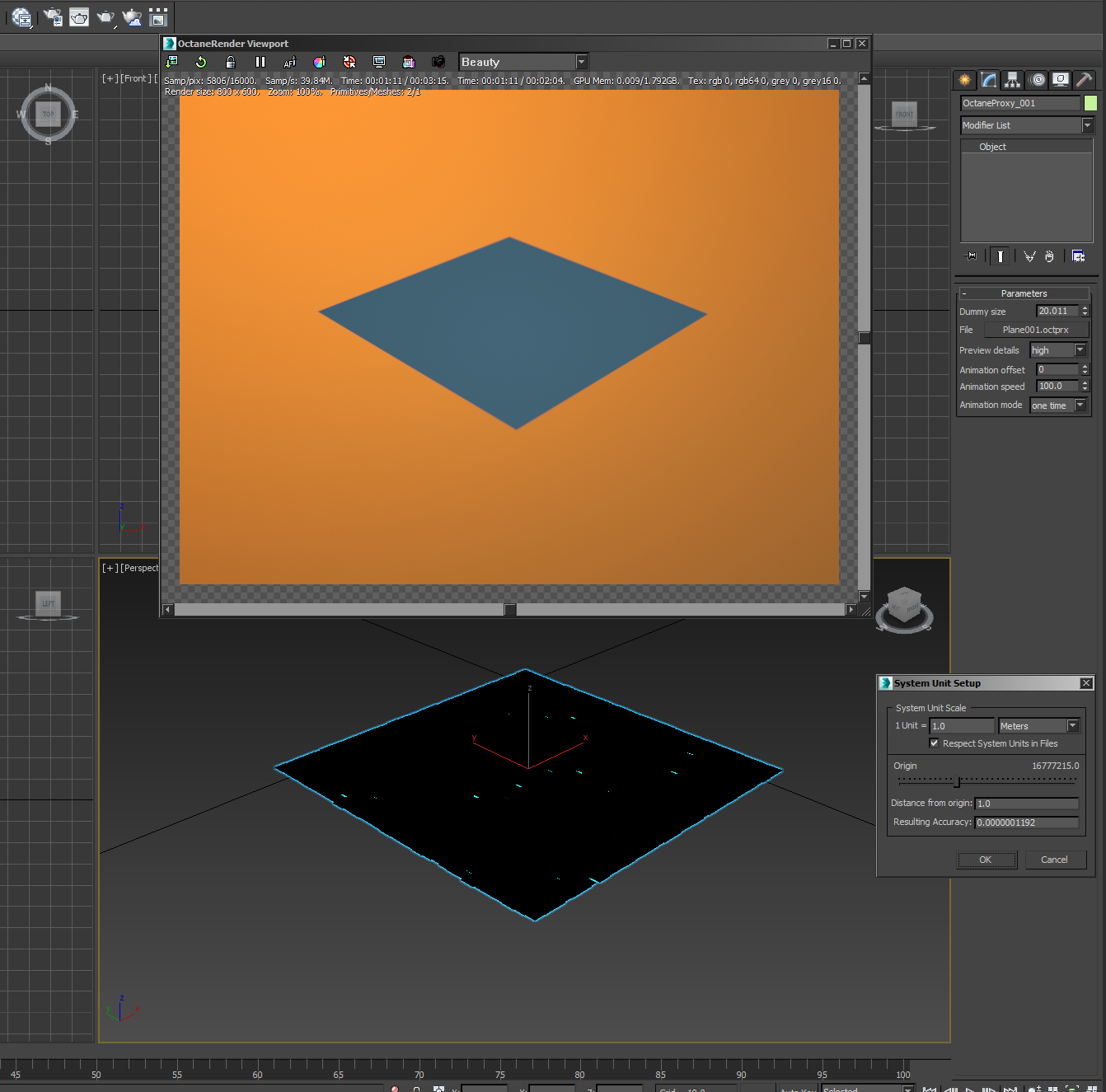

JimStar
Posts: 3852
- The system units are set to centimeters.
- The plane is created.
- The plane is exported to Octane proxy file.
- New scene is created.
- The system units are set to meters.
- The just created proxy file is imported into newly created proxy-object.
What I'm doing wrong?..

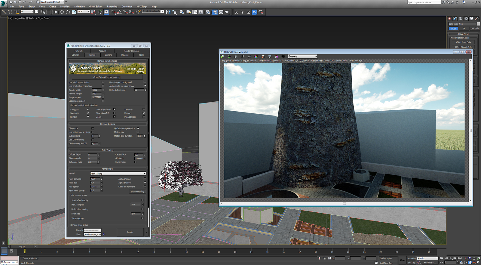

I'll send you the Evermotion Vray tree I converted.
The original tree was modeled in centimeters, I created the proxy, merged into a meters scene.
The proxy was visualized ok when I merged it in the new scene but was rendered huge.
I saved the scene, closed Max, started it again and the proxy object was visualized huge in wireframe. I scaled it manually and was rendered ok.
I closed Max, started again, I loaded the same scene and the proxy tree was visualized tiny.
Crazy behavior!
It seems that switching scenes between different scales the proxy model is not updated.
In few fords switching from different scenes without quit Max some imported-merged Octane proxies aren't updated.
Probably some 3d libraries were created without reset the scale.
I'll send you the original model.

My question was rhetorical.
Regarding the "crazy behavior": please, do not post the "bug reports" on some old four-version-ago versions without even reading the changelogs of the new versions. It was already fixed exactly after the previous report regarding proxies display scale...
JimStar wrote: Changes of the 2.0 version
  • Fixed one more Octane proxy preview scaling issue: in the case the scene unit scale was adopted from loaded file having proxies in it.
