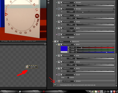

If you save your work in octane you could work later on with the same settings.
For example, you still work with octane, pause the render process, go to c4d, change your mesh -> export (only not render)
to obj -> overwrite old obj -> back to octane -> hit obj node and import new mesh.
For materials have a look to the manual page 68 ff, it is to complicated to describe here.
