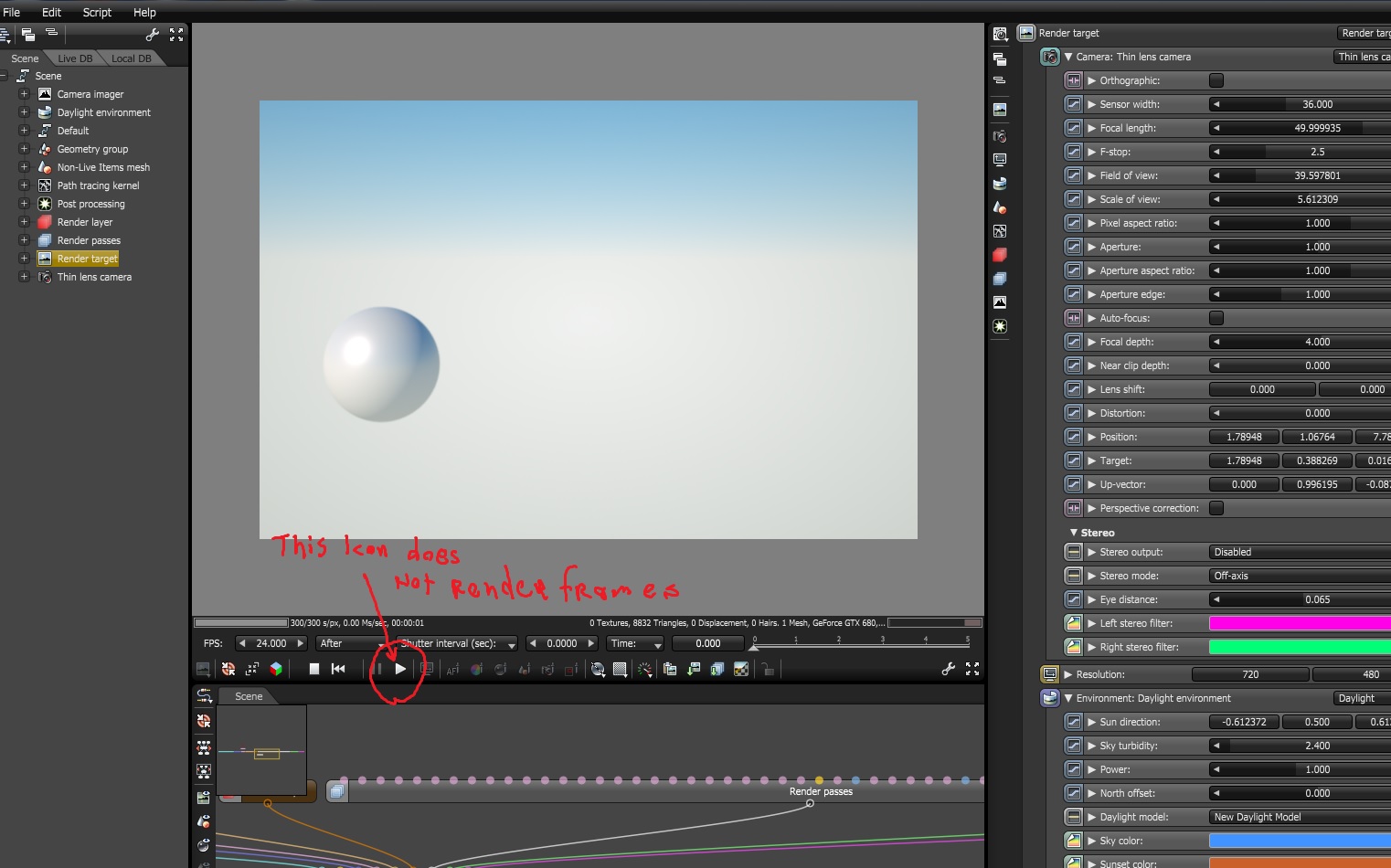

Sorry there is a misunderstanding I can render within modo no problem but I cannot render an animation within Octane Standalone. The weird thing is that I can scrub through keyframes in Standalone but the render frames doesnt work for me. I have attached a screenshot showing the icon which wont render any frames

The button you have highlighted is the Start Rendering button. The timeline is off to the right.
Might I suggest you have a read of the Octane Standalone manual. http://render.otoy.com/universe.php#rStandalone

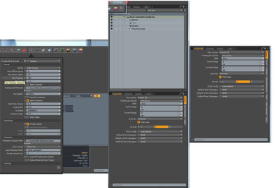

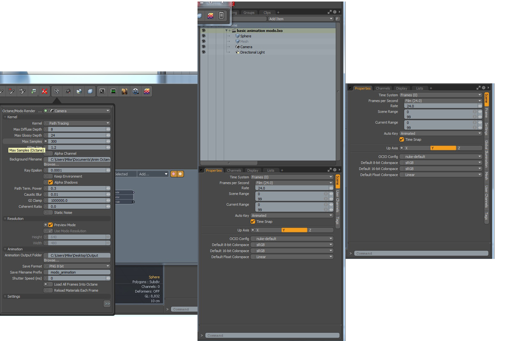

Yes I know what those buttons are for but after I upgraded to Modo SP5 they no longer work. Here are some screenshots of my settings

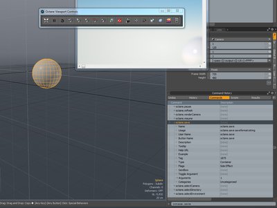

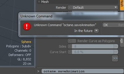

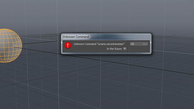

I have made a little progress finding where the Modo command is located on the Modo interface I can see all the commands but I dont see an octane.saveAnimation in there I have tried entering this into the command window but I get an error message. I really want to get to the bottom of this because I could render animations before no problem but after I upgraded to SP5 I cant seem to get it to work the main reason I bought Octane for animation rendering. Can you help me out with this problem I cant seem to find any help on google and I have read the manual but still cant seem to get animation working in Octane Standalone. Can anyone help me out I really want to get animations working again.
