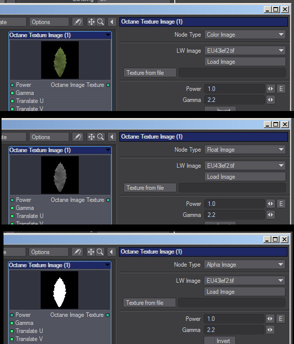

I was playing around with the tree I got from xfrog to test instancing and cloning. I managed to create the nodes for Octane quite easily once I knew how. But the rendered result for the leafs didn't look correct. I checked the alpha map, and -as the manual suggests- the Node Type was set on float. The little preview image displayed the alpha map correctly. I then changed the type to alpha and now the preview display was all white but the render was fine. Is this a bug?

Humpti wrote:I was playing around with the tree I got from xfrog to test instancing and cloning. I managed to create the nodes for Octane quite easily once I knew how. But the rendered result for the leafs didn't look correct. I checked the alpha map, and -as the manual suggests- the Node Type was set on float. The little preview image displayed the alpha map correctly. I then changed the type to alpha and now the preview display was all white but the render was fine. Is this a bug?
I am not sure. In the texture image node, the color mode means that Octane uses the RGB for texturing, the float mode means that the texture is monocrome (or it is converted from RGB to luma), and the alpha mode means that Octane uses the alpha channel of the texture image as float texture. If you want to send me the texture I could check it here.
Ok, I checked and it has an alpha-map. I was irritated, because Octane converted it as float. All is good. The textures are tiffs. I would prefer a masking map and a background in the color of the border of the leaf.

I am testing your image here and the preview seems to work fine. You get the RGB, the float (converting the RGB to luma), or the alpha available in the tiff file. For clipping you must use the alpha, linked to the opacity channel of the Octane material.
Yes, with Node Type alpha it works fine. In the first version LW created a 'leaf(1)'. When I replugged the 'leaf' the preview display was fine as was the rendering. So if any bug at all, it's a LW one and not an Octane one, but probably it was just me when I pushed a button ;), I really don't know.
