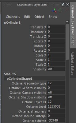

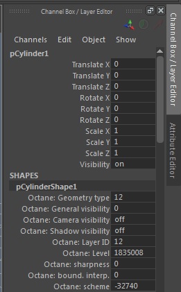

It looks like this issue with "nonsense" values in the Octane geometry attributes is back in 2015, and also 2016: http://render.otoy.com/forum/viewtopic.php?f=28&t=46278. Screenshot here is from 2016, but I'm also experiencing this in 2015 SP6.

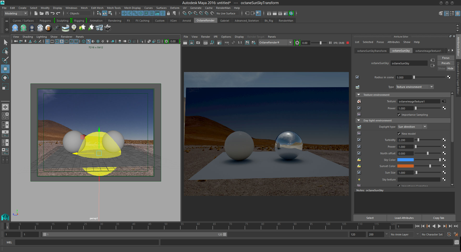

The Sun/Sky node still affecting image background.
To try fix this I need change the exposure in camera settings. But in some cases this not work.

gabrielaraujo712 wrote:The Sun/Sky node still affecting image background.
Please always read the versions descriptions in the header post if you download the test-versions here.
JimStar wrote:Implemented support of camera image planes. Remember that Octane is unbiased renderer so don't expect all the image plane's biased features implemented. All you get - the "real-world" textured diffuse panel, which acts like real-world object inside the scene.

dsyee wrote:It looks like this issue with "nonsense" values in the Octane geometry attributes is back in 2015, and also 2016: http://render.otoy.com/forum/viewtopic.php?f=28&t=46278. Screenshot here is from 2016, but I'm also experiencing this in 2015 SP6.
Strange... All is OK on my side.
I've just tried in 2016:
- New scene (Octane plugin disabled).
- Create cube.
- Load Octane pugin.
- All mesh Octane attributes appeared, all have correct default values...
I suspect there may be some glitches in Maya regarding this - looks like they are nothing to do with the plugin... As what the plugin does during its loading - it registers new extension attributes for Maya node classes, supplying Maya by all the needed info about new attributes including their default values. So, it is Maya's responsibility to not only populate all the existing nodes of given class by new attributes (that Maya does correctly), but set the correct default values for all these attributes after creation.

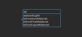

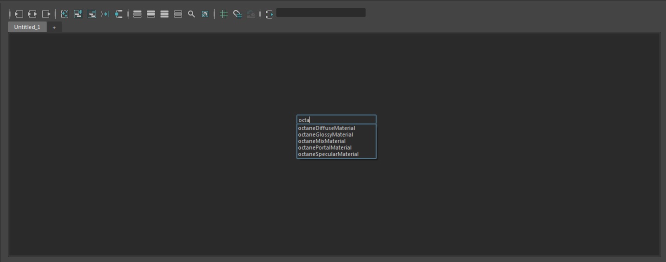

dsyee wrote:Also, in 2016, hitting Tab in the work area only gives access to Octane material nodes. Obviously there are other ways to get the other nodes in there, but could we get them to show up with Tab, as well?
Just tried it in Maya 2016, all the non-Octane nodes are present too.
