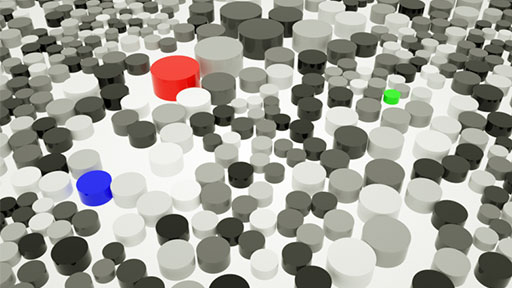

NickBD
Posts: 6
Joined: Mon Apr 27, 2015 2:29 pm
It's still not quite right; though I do see where you're coming from. Your example isn't so much "color per object" as it is "color per x translation".
However, your use of texture projections gave me a solution, so thanks again for your input.
The solution is essentially a lookup table generated by the number of objects to affect. This table is written to a bitmap, which can then be used in a material channel. It's quite limited, not least of all in its scrunching up of an object's UVs, but for me and what amounts to simple objects sporting uniform colors, it appears to work pretty well.
I've written it primarily so that I can color objects procedurally; though as a light-hearted exercise, download the ZIP, paint the enclosed EXR in Photoshop (remember it's one object per pixel), and see the resulting effect on the color of the objects in Cinema.
Here's an example in which all objects are colored with random greyscale values, apart from three that have been targeted specifically. Again, only one material exists in the scene.
Possibly of help to someone (... though probably not :))
Cheers,
lookup.zip
(381.5 KiB) Downloaded 240 times
