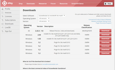

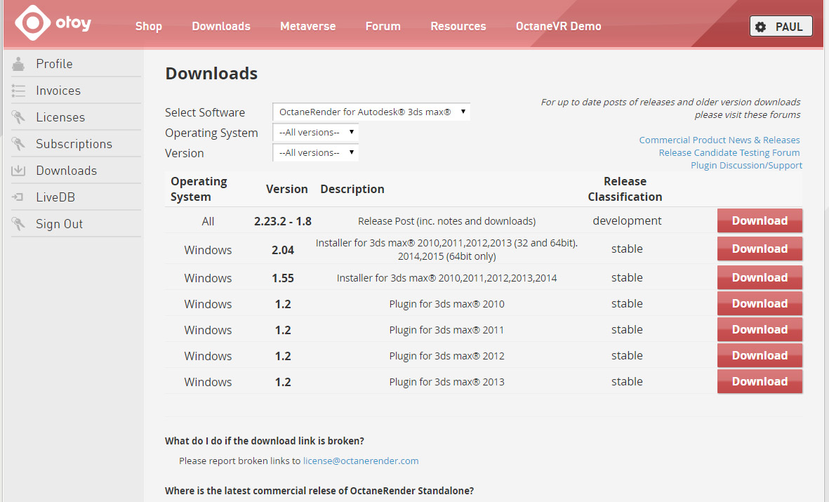

Version 2.32.2 - 1.8.
That's the link at the top of the Download page which I arrived at via my OctaneLive Accounts page. Though I see now that particular version is labeled "obsolete." Seems like the download page hasn't been updated?
I'll try the topmost stable version link and see how that works.

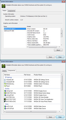

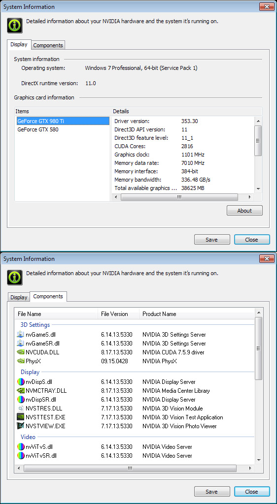

senorpablo
Posts: 163
Joined: Sun Jun 28, 2015 2:52 am
Latest video drivers installed which report CUDA 7.5.9. Is there a newer version to be had? It is odd that no one else has reported this issue. Perhaps it's something to do with the GTX 980 Ti, being it's relatively new?
