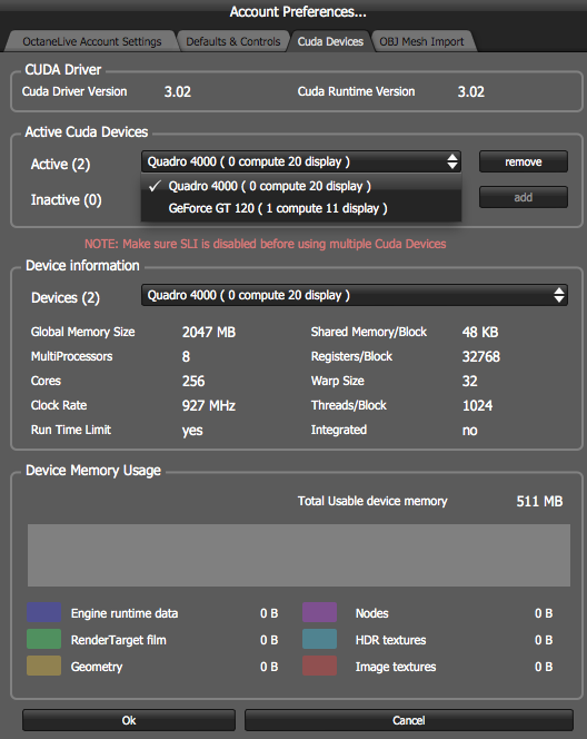

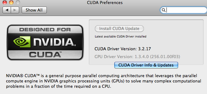

Hello,
i am a new user, was all exited after i played with it on PC to finally use it on my mac, bought the beta, and now, its not working,
i have a mac pro 5.1 12 core with the Quadro 4000 and the GT120.
i have all the latest drivers toolkits etc, and the app starts fine, but nothing ever happens in the render viewport,
my demo version on PC works fine, but nothing here ;(
And when i close it i get this error crash report
Any ideas?
Thank you

Posts: 10563
unfortunately there are other user with the same setup and the same issue, I think that the drivers are too new for octane. I hope that the incoming v5b with cuda 3.2 could fix it
look at here:
http://www.refractivesoftware.com/forum ... =14&t=4637
ciao beppe
