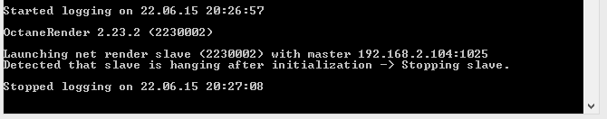

Does anyon know what this error msg. means?
'Detected that slave is hanging after initialization -> Stopping slave.'
slave hanging.PNG (4.76 KiB) Viewed 1535 times

This error message means that the slave got started and sent some initial information about itself to the daemon, but then didn't send the heartbeat to the daemon. The daemon then assumes that something went wrong and shuts down the slave.
I replied to the other thread. If you try out to produce some log files we can hopefully find out what's going on here.
