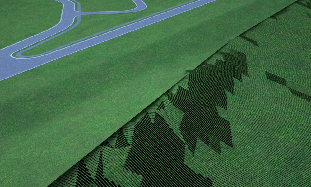

I'm getting this strange effect in one file. Have any of you ever seen it? Both green objects have identical material and mapping.
Strange artifacts(?)

Try setting the rayepsylon at 0.01 or 0.02. That worked for me.

Thanks. I'll look into that. This was really weird. I ended up collapsing, exporting to 3DS, then reimporting and that did it.
