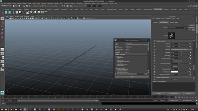

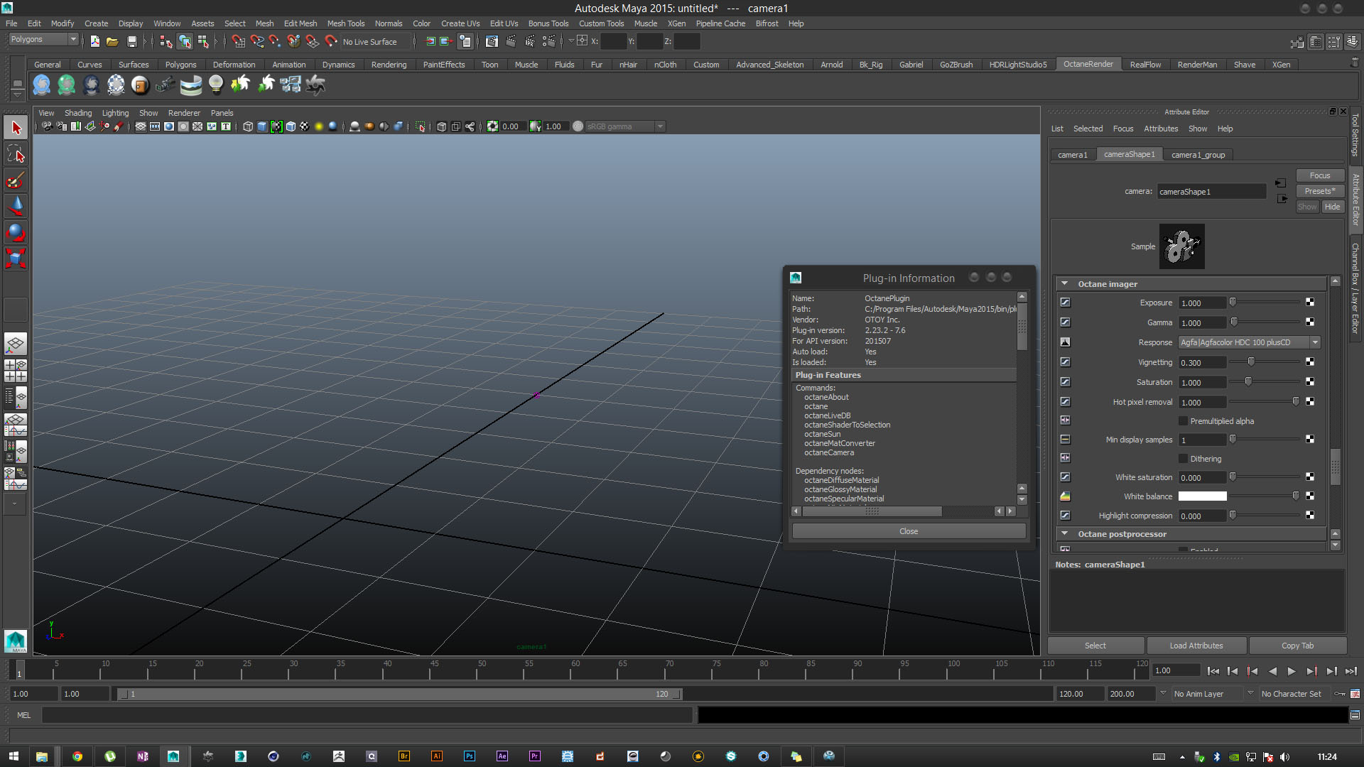

Hi!
Where is ISO and f-stop in Octane Imager? In the previous version (2.16) had ISO and F-stop but in the new version (2.23.2 - 7.6) is gone.
Asus Maximus VI Extreme | i7-4770K 3.50 GHz | 32 B Ram | 2x GTX 780 | Win 8.1 | Maya 2015/2016
Posts: 10525
the ISO and F-stop parameters were removed in the Standalone some versions ago due to the fact that they were the exact same thing than the exposure itself, only with different scale.
ISO has no effect on the grain in the render and the old F-stop does not affect the DOF, so they bring confusion.
Now, in the Image Camera node you find only the exposure parameter and the F-stop is moved in the thin-lens camera node to correctly control the DOF ;)
