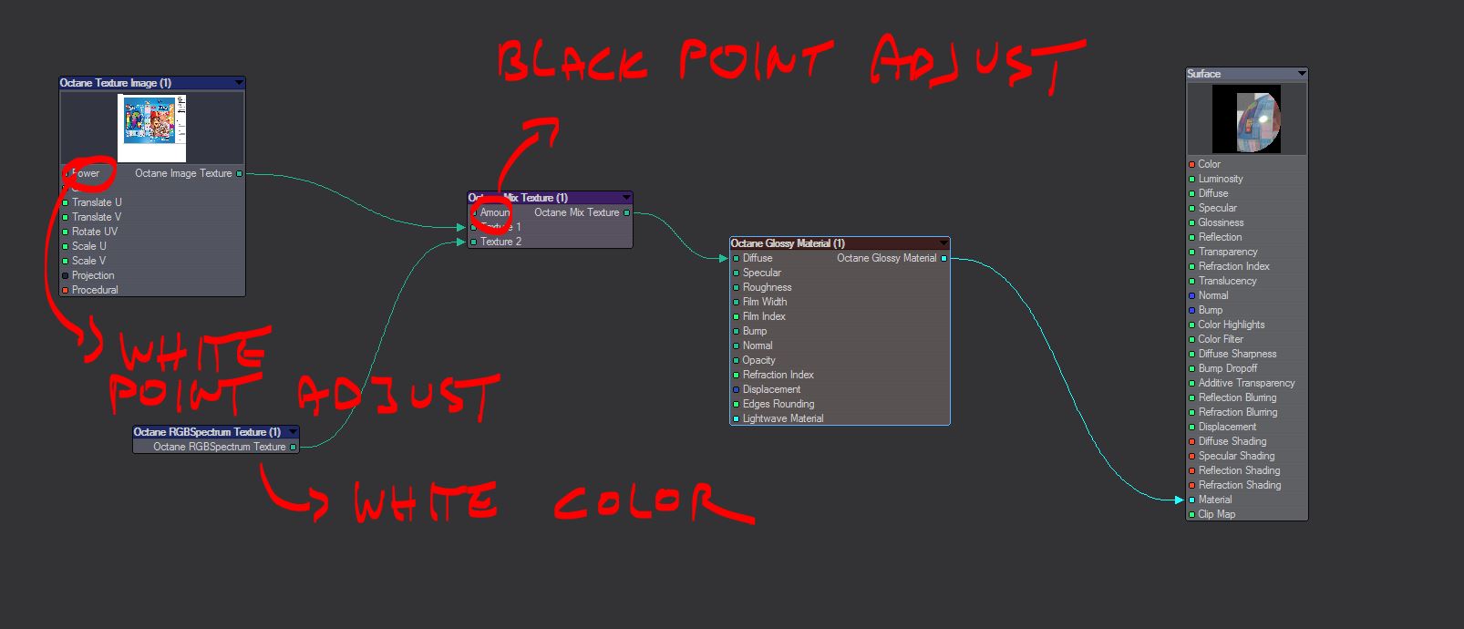

You have to mix the texture with the white RGB value to adjust the black point, and white point is adjusted using the power in the texture image node. So you don't need color correction node at all.

I'll need it for contrast adjustment, but I can just feed your solution into it. Thanks, I'll give that a try.

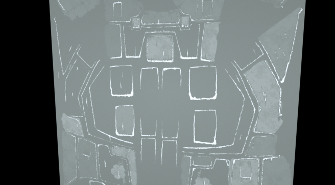

Anyway, tried your solution and it works a treat, except for this bloody gamma difference problem with Lightwave.

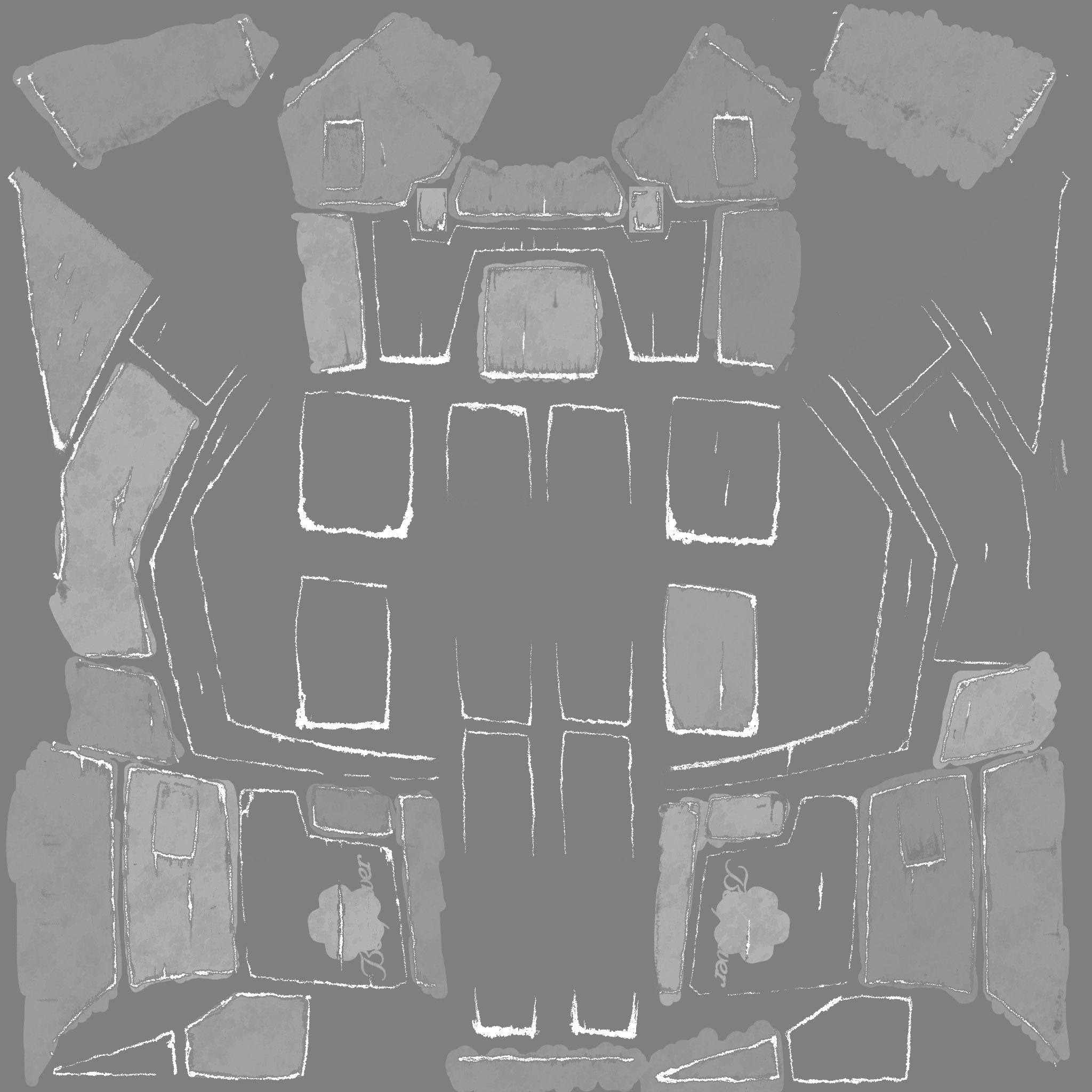

This is the original....

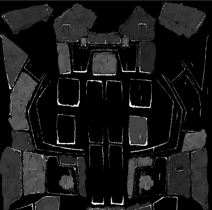

this is it in Photoshop with the black point adjusted to 128 (50% grey)

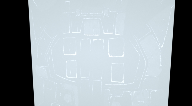

this is it in LW with the adjustment to 50% (with your node setup)
To get it similar, I've had to adjust it to 12%
This is ok, but the adjustments I'll lactaully be making with be darker than this, and 1% is a lot at the bottom end in LW>

That's weird. My 128 image looks darker once I've posted it.
gordonrobb
Posts: 1247
Joined: Sat Mar 16, 2013 9:08 am
Replaced it with a JPeg and that works
