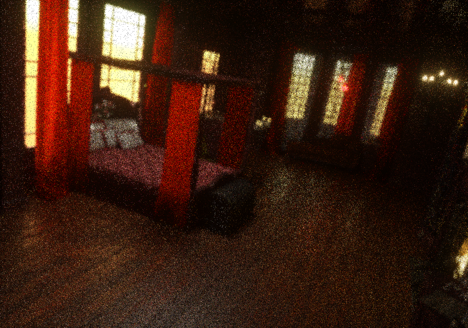

Here is a 1 sample render that's good:
As you can see, the floor, and other things illuminated by environment lighting are already visible, take note this is a 1 sample render. Once it gets to 100 or so, the image will be mostly visible and it will then just spend the rest of the time getting rid of the noise.

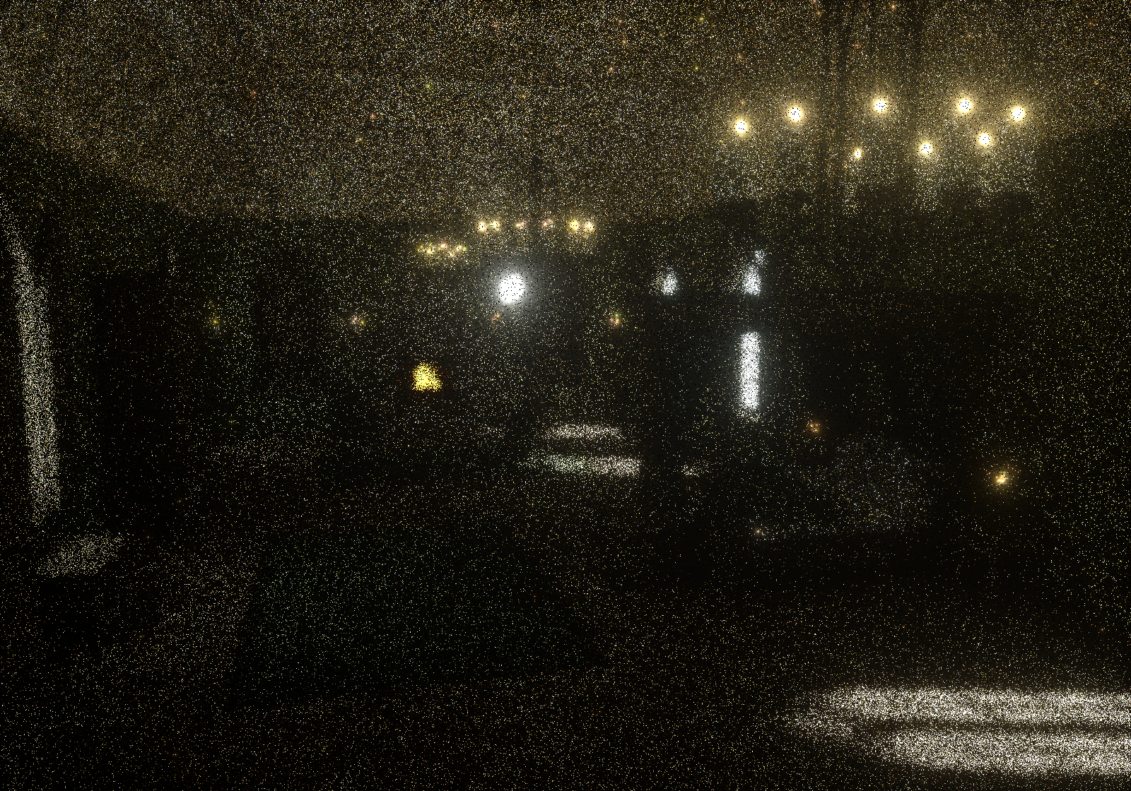

Now here is a bad one:
It starts out almost completely black and, as you can see, it's just an orgy of pixels which, left to continue, will just fill out the image eventually but never go away. Nothing in the room is already illuminated and it's basically treating the environment lighting as if it ware a black body in a dark room. Messy.

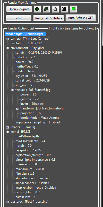

Both scenes use the same render settings:
Here is a 16000 samples render that shows the noise never goes away. It's a simple room, bed and the guy. Only daylight, same settings as above.

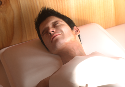

Ware I to take this model and place him on the bed in the first image, he would look like this at 500 samples, not 16000.

A small update in case somebody else experiences this problem.
It was displacement maps that caused the blotches on the skin. Looks like even though you may have the "Convert Displacement Maps" off in the setup, Octane will still sometimes load them up for some reason.
So do check those out if you experience problems like these.
