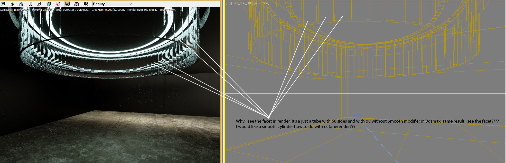

I don't get smooth rendering in simple cylinder or tube creation in 3dsmax, I already see the polygon face on final rendering, don't understand why, I never have this problem with vray or other.
Perhaps I made something wrong??? It's a simple cylinder and I have same result event if I add smooth modifier, alway same??
precision: my scene is enlightened only by hdri image
help please

i think the best way to solve it is to send this scene file(or a smaller one with same issue) to Jimstar.

...Or attach ZIP-ed scene here, we'll take a look on it.

I had a similar problem with the cylinder of a vacuum cleaner.
In the options for your specular material, have you ticked the box that says 'Smooth'?
That solved it for me
All the best
Mark
