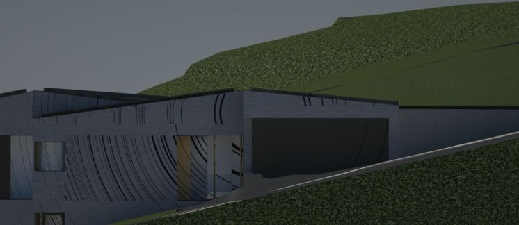

Hello!
I setup a scene with a camera at 1 km from my building, zoomed with a 400mm lenght (to remove perspective like an orthographic view) and I tied up the camera to octane using the nodal trick (I render the grass and plants directly in lightwave and need a match between lightwabve and octane camera for compositing purpose. There are too many instances to render with my dual GTX 780 ti)
I get this very strange circular patterns in my renders...

It's definitly based on the distance/focal as I get rid of those artifacts when I move the cam to 500 m from the subject and reduce the lense to 200mm. I guess there is a limitation in Octane..

adjust your ray-epsilon setting :idea:

Dammit... right the ray epsilon!
Thank you, totaly forgot about this one!
