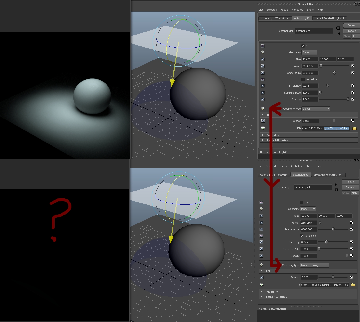

Hi JimStar,
When I create a OctaneLIGHT with Geometry type: Global IES light use it properly
But I use a Geometry Type: Movable proxy, Scatter and Reshapable proxy IES light they are not equal with Global. :?
Is this a bug or not? :evil:
sorry for my bad English
JimStar
Posts: 3829
matrix2012 wrote:Is this a bug or not? :evil:
No, it's not.
You'll get the same difference in standalone after exporting the scene. If it so important for you - you can set the "Scale" in Octane global settings to "1.0".

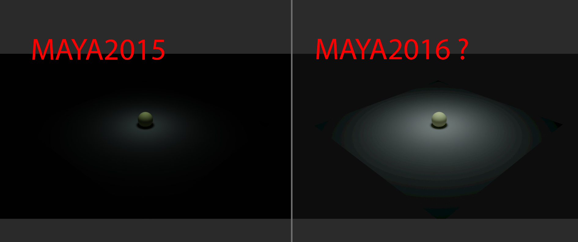

Hi JimStar
1:
The light is not the same with Octane Render for Maya 2015 and Octane Render compared to MAYA 2016 ?.
In Maya 2016 error.
See screenshots 1-2.

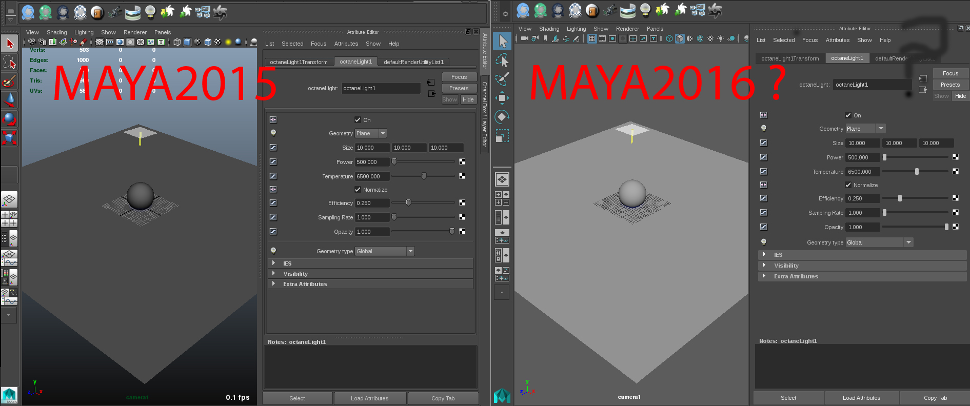

2:
In Maya 2015 and 2016, the export is not with abc.
see screenshot 3 error message.
