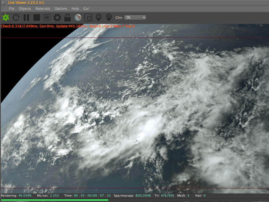

I need a little help on this. I'm trying to figure out how to get something similar to the picture below:
I'm fairly close, but its lacking a few things. Mainly that blue hazy glow on the horizon. I have a fog texture on the outside of the sphere, and thats kinda working, but not quite how I want it to.
Here's my attempt so far:
My scene is built up of three spheres stacked on top of each other. The inner sphere is the earth texture, the middle sphere is the cloud layer, and the top sphere is the atmosphere haze. The cloud layer has displacement on it so it catches the light and casts shadows. I've included it for anyone who wants to take a crack at it. Thanks!

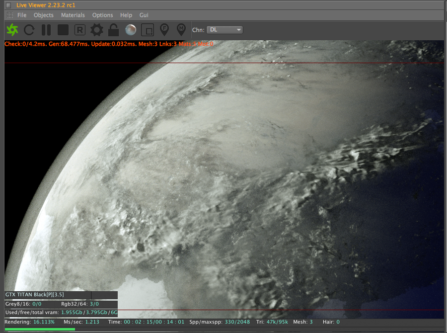

Ok, dug up an older project that used scattering for fog, and i'm definitely getting closer now. My bigger issue is figuring out how to fade out that hard line on the atmosphere. I want it to get fuzzy at the edge like a falloff, and i'm not sure how to do that with the scattering node.
