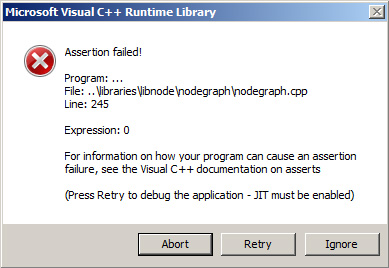

Thanks for the reply, now everything works fine... but now I need to figure out why is octane crashing when I'm importing some object from another project into octane, I collapsed all modifiers to editable poly and all... but when I hit Render in max2octane, it opens octane, starts to load, than crashes with an error:

Yes, that's the other most annoying bug, that together with the relinking problem causes a lot of frustration... A workaround is described here:
http://www.refractivesoftware.com/forum ... =23&t=4272
In a nutshell: When you use nodes to override materials, make sure that there are no gaps between pins connected with nodes and pins that are not connected.
Again, all these problems will be solved with the next release.

well about nodes and all... I can't even open the scene in octane... when I hit "render" to edit my materials and setup the scene before "render animation", octane starts to load and this error pops out and I can't do a thing inside of octane...
about materials, I even setted up the scene with standard default gray material with no texture, same thing
