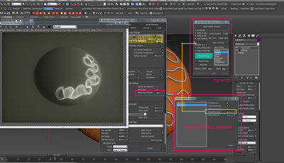

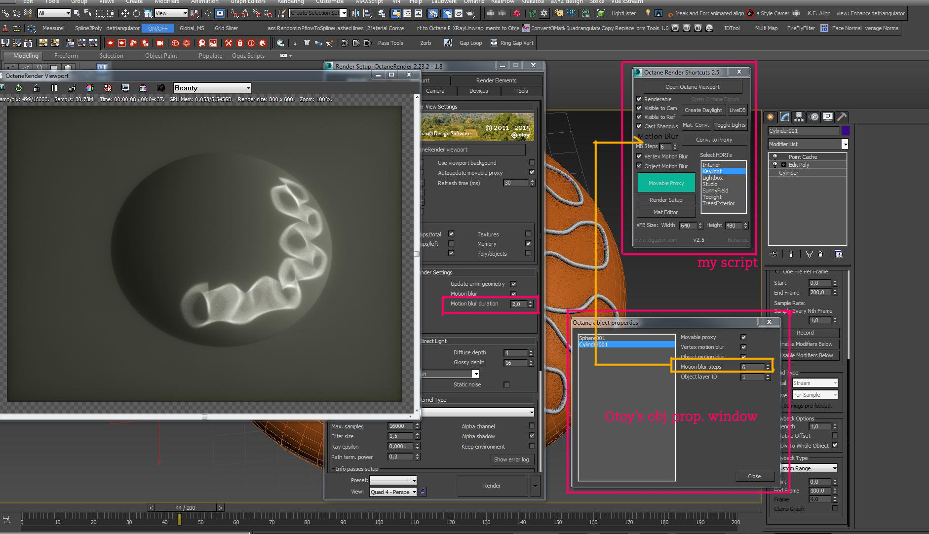

I've attached a sample scene, where there is a point cached simple object with motion blur.
The problem is all motion blur settings are not updated instantly on the live view.
To update the new setting you have to move the timeline. Wonder why that is the case.
Motion blur duration, motion blur steps (in obj.prop. menu) all do not take effect instantly while the octane render viewport is on...
In addition to that.
I wrote a shortcut script for max earlier and shared on the forum. Where you can change few octane setting with a single click on the fly.
I also managed to add Motion Blur steps settings to the script. But this also doesnt let the scene update on the fly. But it does change the object property on the fly. The problem is coming from the octane plugin it self.
On the other hand Octane obj. properties menu isnt working on the fly. It's locked window. you have to close it in order to see that effect. And if you changed the motion blur steps there. it still doent update instantly, you have to advance the timeline to see the effect.

I've seen this in code.oguzbir wrote:Lastly, I don't know how many times I asked for this. And there were no replies to this matter.
But maxscript compatibility doesn't work at it's best.
For starters there is no maxscript connectivity with octane render settings.
This has to be solved at some point. I simply cannot tell the benefits of maxscript conenctivity
And this is the real problem: this plugin from the beginning was designed this way, not using the standard Max properties for Octane render settings and instead reading/writing their values directly to/from scene file. I can fix this, but this will totally break the scene-files compatibility with previous plugin versions. That means - all properties will become default values for all the Octane objects if some old scene will be opened in any version of plugin older than the version where it was fixed... "On the fly" conversion will be impossible to implement, as the way how the information is stored inside the scene will be changed dramatically in this case.
Moreover, there are a lot of other things which need to be improved/fixed that require the compatibility breakage. So, if the Octane render settings MaxScript compatibility will be fixed, it must be done together with a lot of these other fixes that break the compatibility too... I even see these other things more important...
But, at least so far - I'm still thinking if this should be changed at all... As I just can imagine what for amount of crying from a lot of artists will be heard after that... Or should we do this the "Apple way"?..
