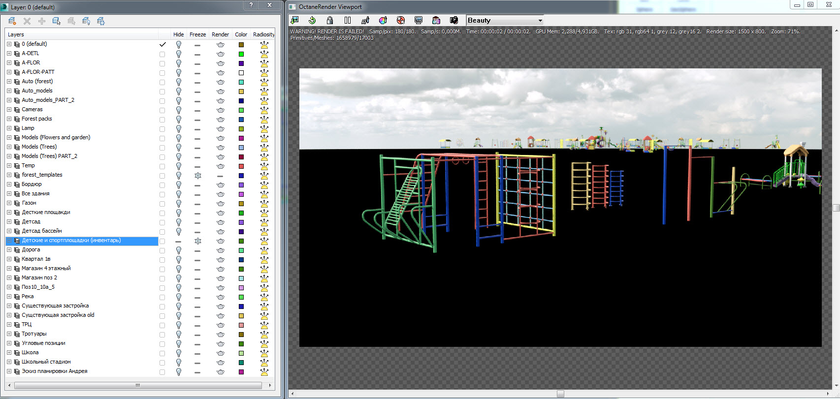

AlexMakhov
Posts: 21
Joined: Thu Feb 12, 2015 12:22 pm
All layers off except the one that causes the error.
