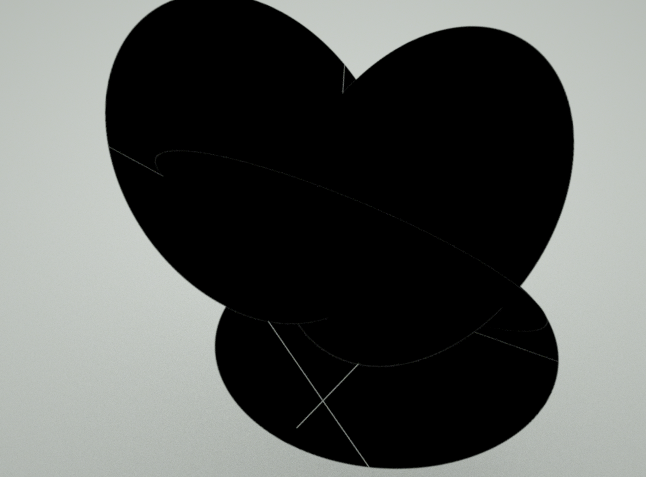

I (and my friend confirmed) noticed strange and very big problem when using opacity maps.
The problem does not occur with VPR so it must be in Octane or Octane LW plugin. It is not related to latest plugin quickfix, it happened also with previous update. We have no information for earlier versions as we noticed this recently.

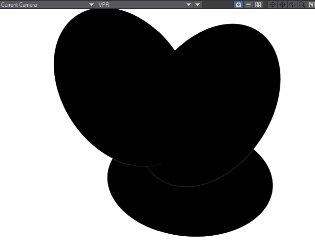

The problem shows best in image so here is VPR capture which works as it should (four black disks that consist of one polygon and uses opacity mask to clip the object). To use this, just turn off the nodes in DotWall surface and use VPR.
Here is the same with Octane IPR (same happens with F9). For this, just turn on the nodes for DotWall surface and open IPR.
As you can see, the object with opacity map cuts any objects that overlap it even outside the visible part.
This makes for example plants impossible to make as petals and leaves objects often overlap.
Has anyone noticed this problem or are we doing something wrong? I don't think so because we have tried all possible settings, used alpha channel in color map etc.

I can confirm this and it is a ray epsilon thing, if you increase it the lines get even thicker. I suppose this is a limitation of the current engine.

Yes, try to set 0.0000001 as ray epsilon in the kernel node ... it is going to show 0.0, but the internal value is ok.

juanjgon wrote:Yes, try to set 0.0000001 as ray epsilon in the kernel node ... it is going to show 0.0, but the internal value is ok.
-Juanjo
WOW thank you VERY much for this and even so fast on weekend! :mrgreen:
It indeed seems to fix the problem!
Antti

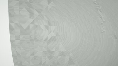

I think 0 is just the smallest value it can work with and you should use it for a very small scale scenes when filming something that is very close to the camera.

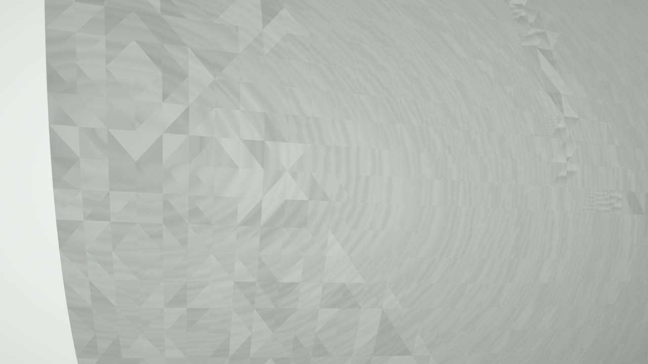

This is a pirate ship sail with epsilon 0:
so all sorts of rendering errors

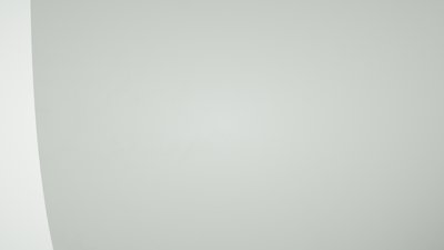

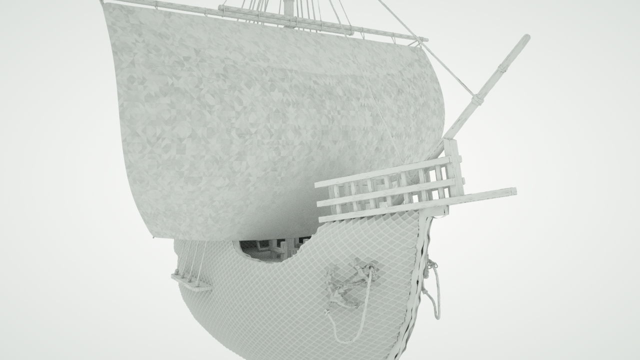

this is the same view with epsilon 0.000008:
looks good

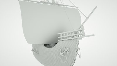

this is with the same epsilon but with camera moved back:
looks bad again

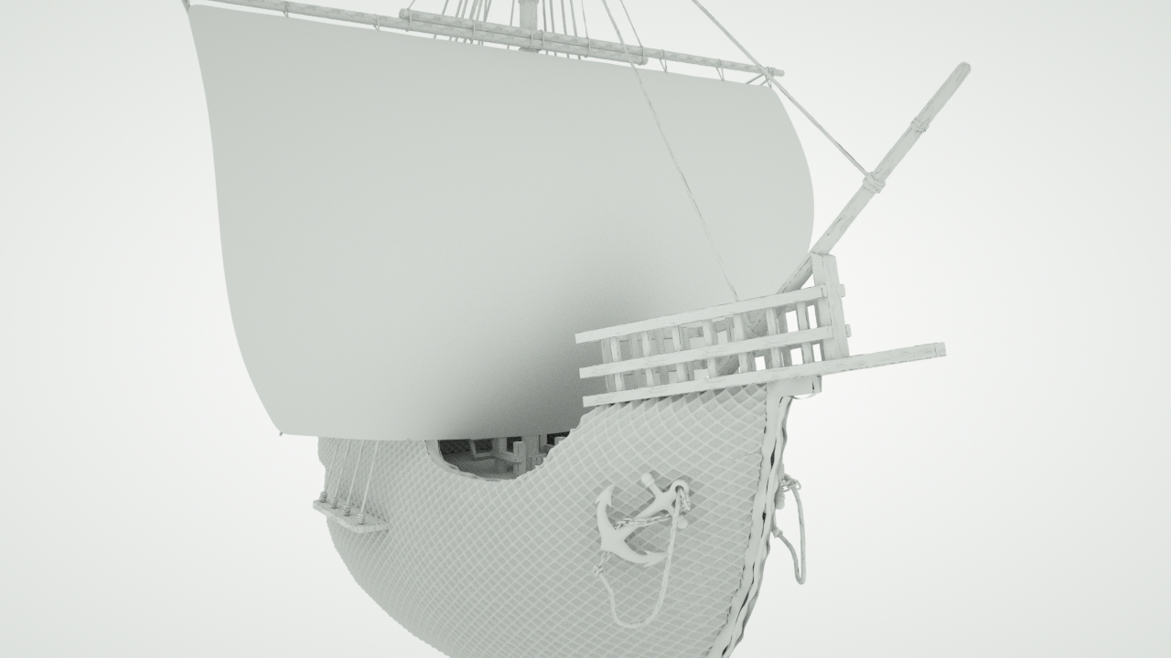

this is with epsilon adjusted to 0.00004:
