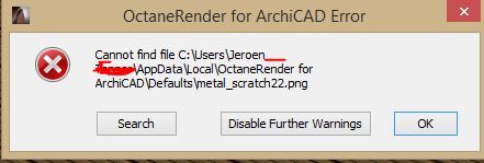

I am organizing everything in a folder on a other computer on a drive instead of in the C:\Users folder.
I want to make this migration as simple as possible.
I have copied all the saved files from one PC to a new PC in a new folder on another harddrive.
Now when importing a material from the new library folder it misses textures and is looking in the C:\Users\Jeroen_... folder but it cannot see it.
Standard the plugin has this foldername (when copied the path)
C:\Users\J\AppData\Local\OctaneRender for ArchiCAD
It has shortened the users name into 'J' by the way while I was using my fullname
Does that makes a difference? Is that the problem.

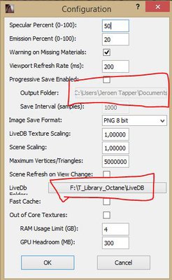

Secondly i do want thetextures to be stored in the other folder, so then I can point to the other folder with search.
But now I have to do that for every imported material, right?
So, is it unwise to have things not in the standard folder "C:\Users\J\AppData\Local\OctaneRender for ArchiCAD'
Then, should I use only 'Jeroen' as user (not full name with space in user name)?

When you copy the Exported material definition from your AppData\Local\OctaneRender for ArchiCAD folder to anywhere else, it will still contain the absolute path to the texturemaps. If you move the texturemaps, they will not be found when you load the OAM and you will need to "Search" to relink them. You can then re-Export that material and the correct link to the texturemaps will be saved in the OAM file.

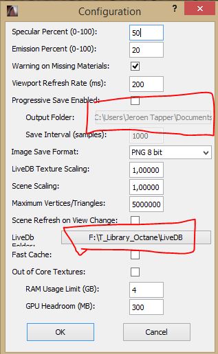

I think a better way to do this is to export to the LocalDb instead. When the materials are saved as ORBX in the LocalDb, the texturemaps are contained inside the ORBX. So you can copy the ORBX to a different location and it will load with the texturemap paths linked correctly.
Are there special characters in your Windows username? If so, I suspect the error dialog is displaying the wrong folder name.

Yes - but AC should "remember" the last searched folder and search their before prompting you, so you could Import and then Export all your OAM materials in one AC session to correct the links.
The local of your OAM files is not too important - it is more important that your LiveDb texturemap folder is somewhere that you can replicate on each PC you have (ie. NOT in your Users folder). Again, if you use the LocalDb this problem goes away.
