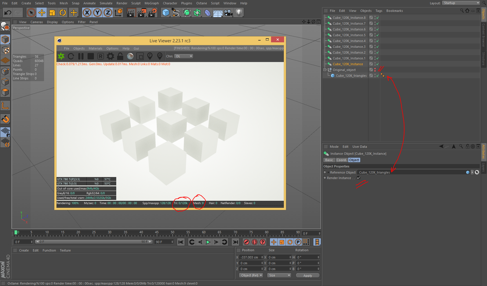

Just like that ;)
Instance_example.zip
(62.35 KiB) Downloaded 159 times

yes just use latest versions

Thanks a lot, very clever idea that I didn't know.
You 've saved my day!

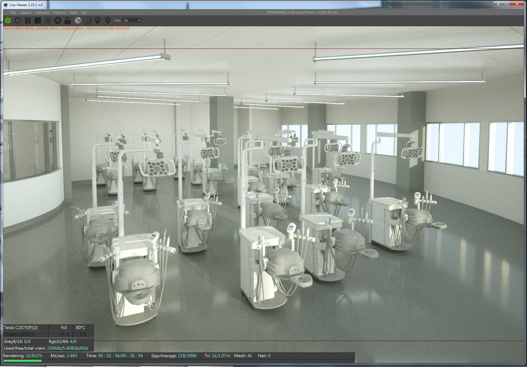

Just wanted to say thank you for this post! I've been struggling with this issue for a long time. Each one of these units in this image occupies about 180mb of VRAM depending on the image size. This little trick works great! It is also worth noting that it works with grouped objects and not just a single mesh. :D :D
