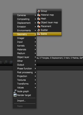

You don't need the Daz version of alembic exporter, its built into the plugin. Under system tab export your scene as obx or animation as abc
In standalone start new project and add the abc to scene using Geometry > Scene > Load.
ABC import
ABC import
