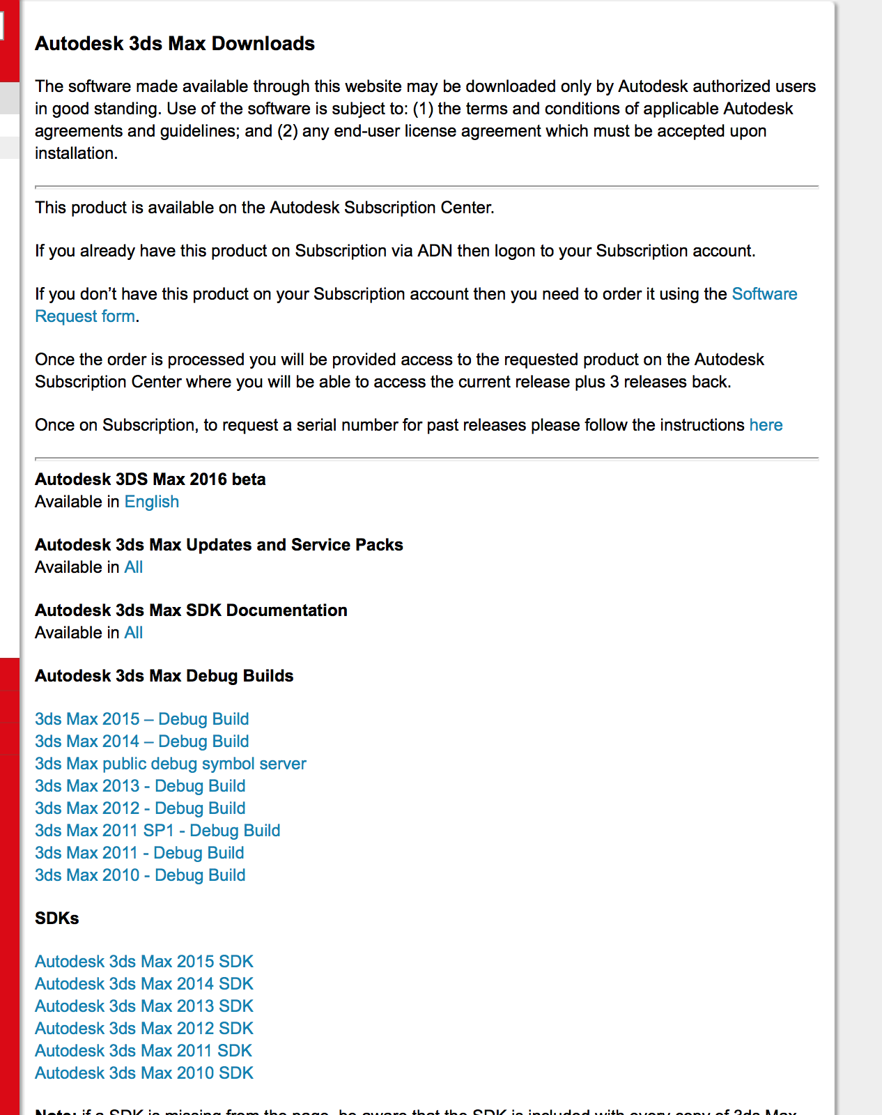

You need to ask Autodesk about that. There is no 2016 SDK available yet.
