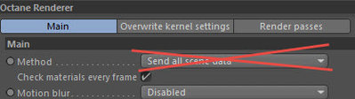

Here is a demo scene
https://dl.dropboxusercontent.com/u/643 ... mp_Bug.zip
Posts: 16068
Location: Türkiye
You are missing the notes of render settings.
moebius
Posts: 95
Joined: Tue Mar 17, 2015 2:18 pm
thank you!
It was not logical for me to change that setting.
