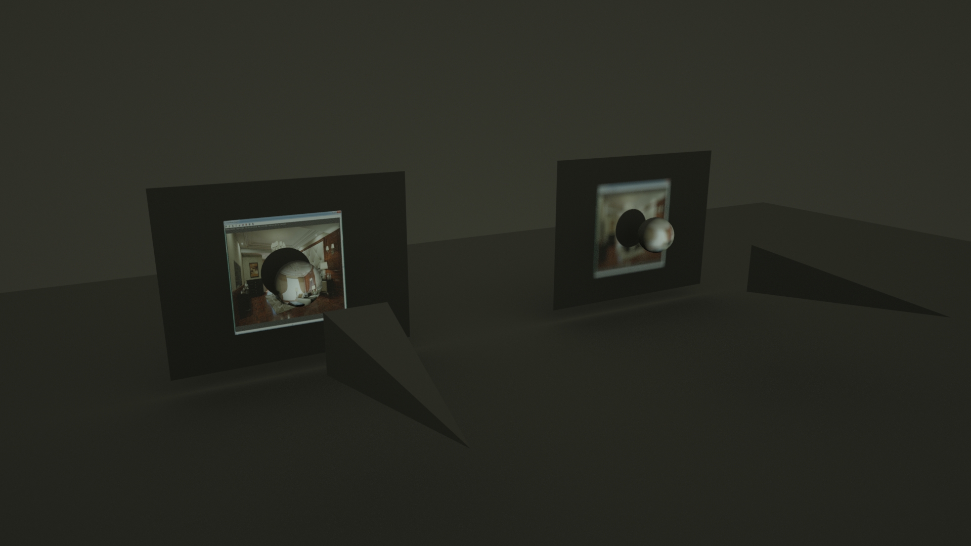

Hi Buggy I made test and you can see result, I also attached test scene, trick for clear projected image is to have really small light inside piramyd. I also tested if I move piramyd 8m picture will be still clear projected

Thank you so much Mark! Do you have the option of saving back to Max 2011? Unfortunately I am still in the dark ages in terms of versions. If not, perhaps you can list the settings on the specular material with the bitmap in the transmission slot. I think that is where my problem lies, since I have made the light as small as Max will allow (.001cm). Also, regardless of what light I put in there, the light is not emerging through the bottom of the pyramid.

Here is 2011 version. Hope it helps

You are a star Mark! I was able to open the file and see it render.

Check the "fake shadows" option on the specular material.buggy wrote:......
I have been working with it. So far the projected image is very blurry. I just shrunk the light even more (to .001cm) and that seems to have helped a bit, but it is still a big blur.....
I don´t know, why this is necessary.
Basically this is like a (physically correct) slide projector: a point light source and a slide in front should result in a projected picture on a white surface ;
without fake, right?
