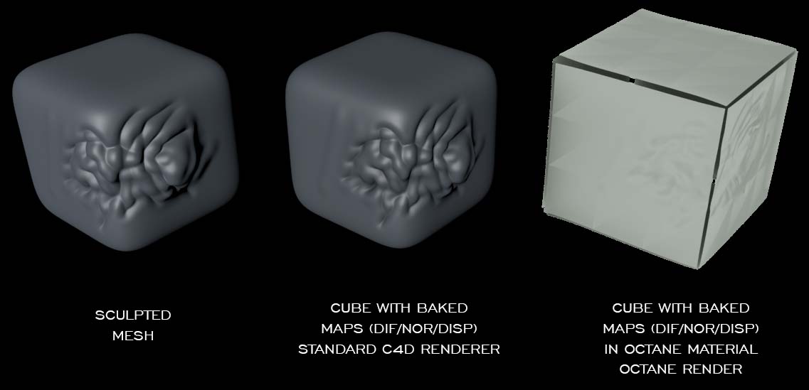

Is it possible to use baked maps from c4d sculpt mesh and replicate same results you get with c4d standard material/render in octane material/render?
I can't get it right :(
Simplified example of workflow:
make cube, go to sculpt layout, subdivide few times, sculpt, bake maps (AO,normal,displacement)
Thanx.

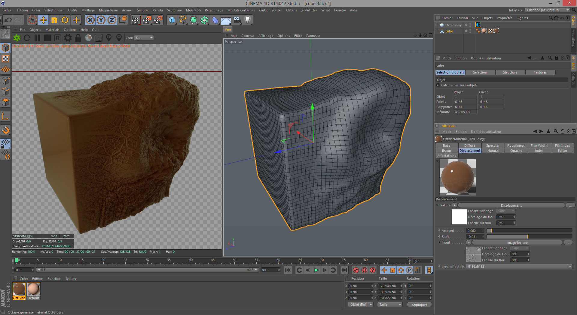

I think you ask too much to the Octane's displacement. Cinema 4D has access to the information of the internal smoothing system of the sculpt subdivision module. The displacement channel of Cinema 4D renderer is then adapted to the sculpt baking. This is not the case of Octane then you should give a little bit more informations by baking your sculpt from a higher level than zero with "keep higher level" checked (by sample level 3 or 4).
I think the baking result is far better with my old Mudbox 2011 than with my old Cinema 4D R14, probably because even with a higher level mesh the C4D smooting is still a problem. Maybe it's better with a newer release of C4D, i don't know. And Octane seems to handel curioustly 32 bits floating point files (i'm unable to restore negative values of the file, only positive values) then i've found the result is far better with 16 bits files "centered" at this time.
Sorry for my poor english. Here a sample from Mudbox in C4D:

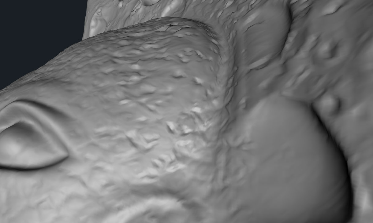

Here a screen capture of the Mudbox sculpture:

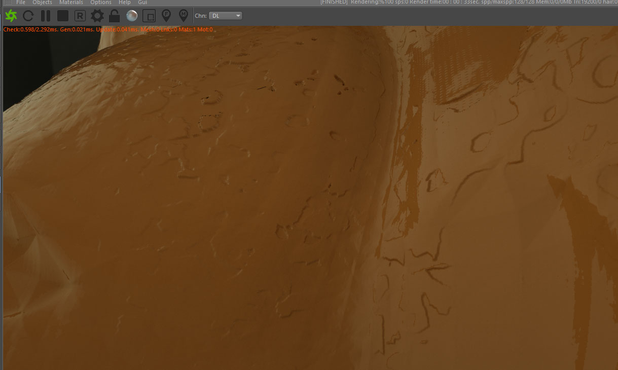

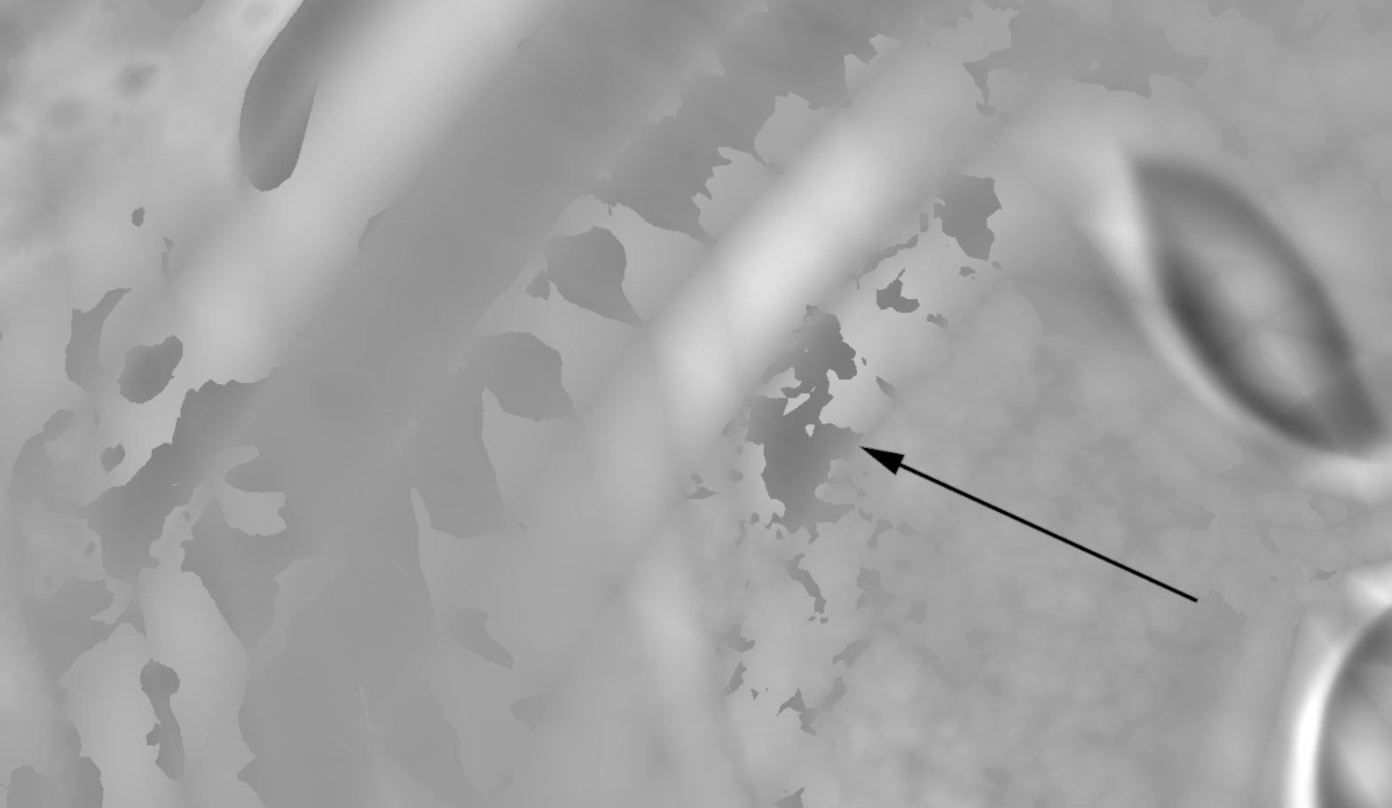

The main difficulty isn't the file format but the hard edges generated by the sculpting baking of Cinema 4D in some circumstances. The result is a little bit better if you keep a higher level than level zero for the base mesh and create a better UV map from this base mesh. As Octane doesn't use Object projection (XYZ as RGB) but intensity (without information of direction), the baking from C4D isn't a "one push button".
Here a sample of hard edges generated by C4D baking
I don't know why but these hard edges doesn't generate cracks in C4D renderer
Of course, these hard edges generate errors in Octane...
