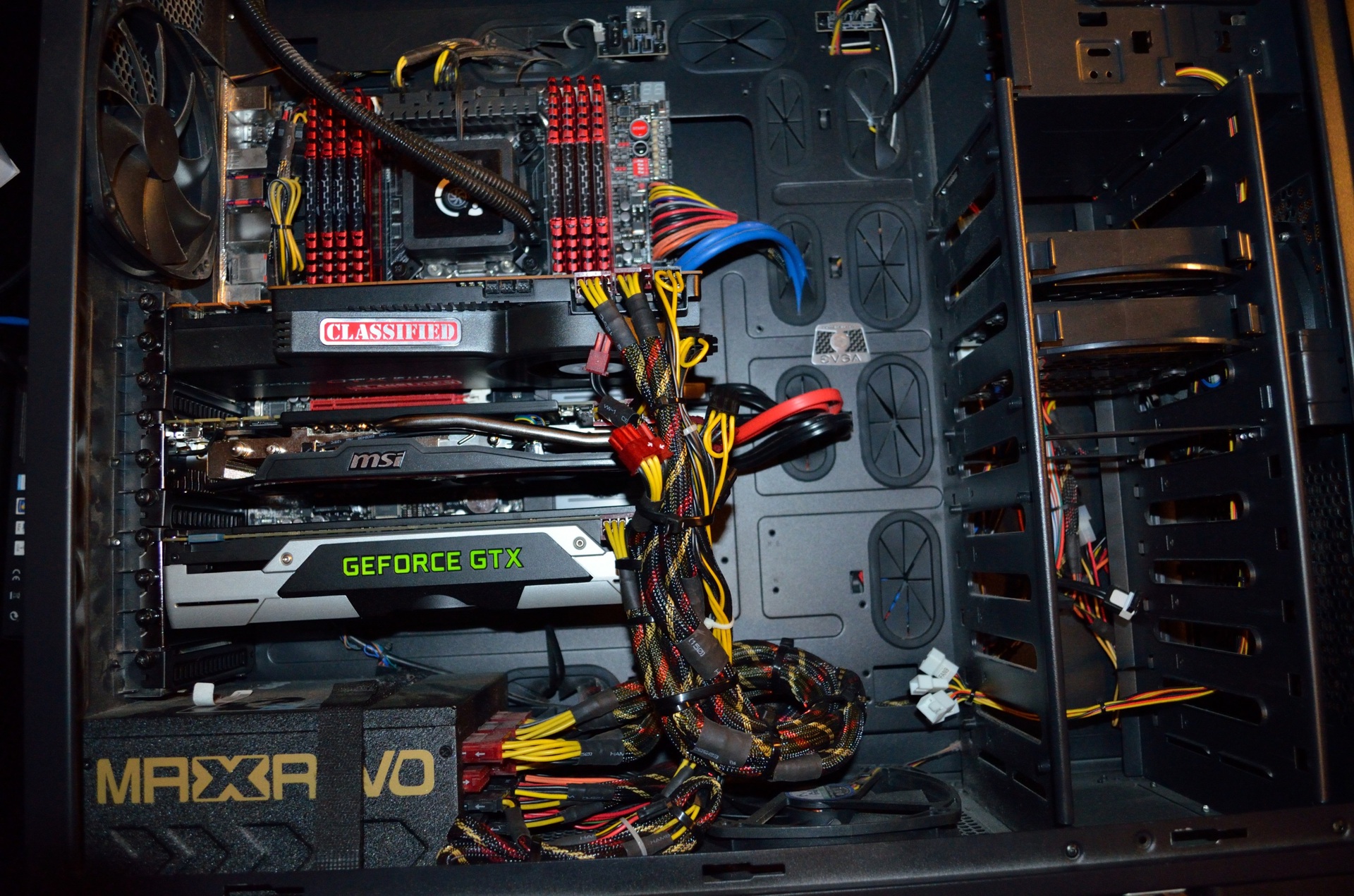

No problems here.. and I ran three differnet series for a little while (580,780Ti and Titan Z)
