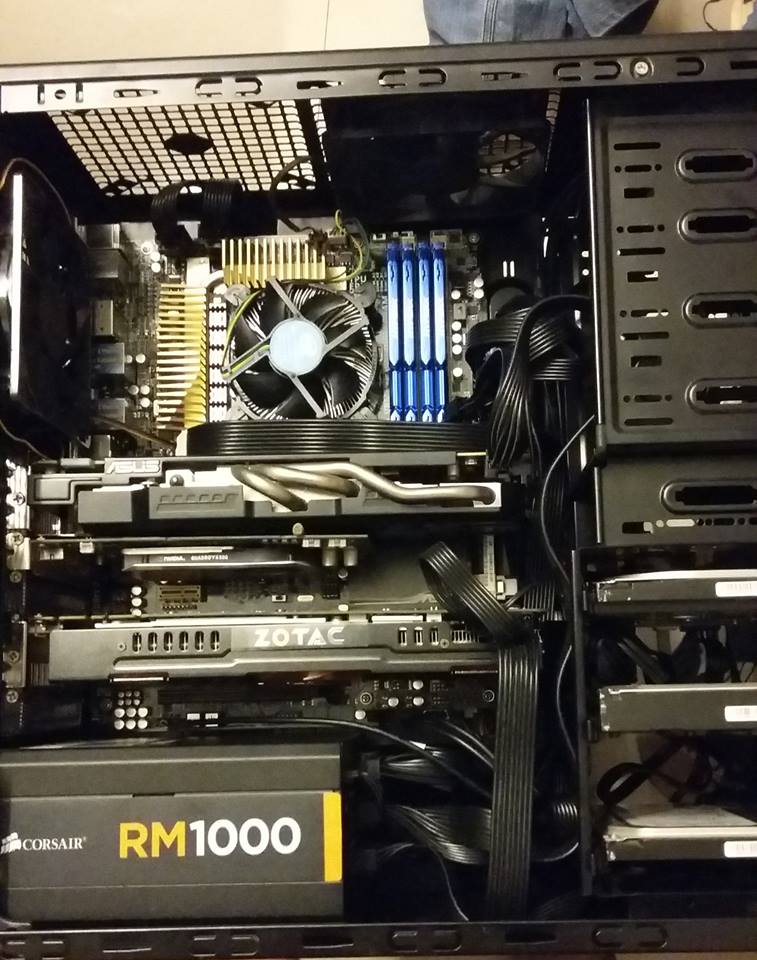

My system and Case as mention.
Case
NZXT Beta Evo
Mobo
Asus Z87WS
Intel i74790K
Gpu
1 x Quadro580 - display
1 x Asus GTX 660- Octane
1 x Zotac GTX 780 - Octane
Corsair 1000W PSU
My Budget is around 800$
AjayVishwakarma
@ Intel i7 4790k, Z87-WS, 16GB
GTX 660 2GB + GTX 780 3gb
Corsair RM 1000W

Going with WC on your 3 different cards makes no sense and would be a nightmare for WC connections between them.
My best recommendation for now: sell all of your gpus and get 1xTitanX - and for now you'll benefit so much on air - this is just one card. When you get 3-4 Titans X then you'd be better off on water cooling.

- the case is way too small for WC (even for AC for many gpus air flow is not too high). What if I may suggest something the most important - start with a new case. This is something new is of great value/WC performance and costs around 200EUR
http://www.phanteks.com/Enthoo-Primo.html
https://www.youtube.com/watch?v=JJDQVonZNMw
- WC 680 and 780 makes no sense - sell 680 (and 580) and get another 780 (identical), or (as I said) sell all of them and get one X (save your 800$, add money from your cards and you have budget for X)

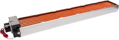

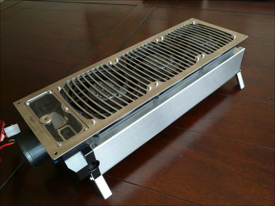

if it would by my money for such upgrade, I'd try to go with something integrated
Aquacomputer Airplex with D5 the main reason being - least amount of mess outside.
You can add fans, grills, stands & You get completelly operating system.
Depending on Your future plans I'd go fot at least 360 but, maybe even bigger. That would be my choise in Your situation. But Smichas route is wise too (to get bigger case) or change cards at all..
Even getting something like simple EK rad simple res & pump would work jsut slightly less effective, maybe more noisy..but I just don't like the mess..(so I'm biased in this extent).
Good luck with Your build & if You have any questions, feel free to ask.
